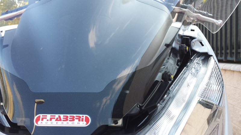

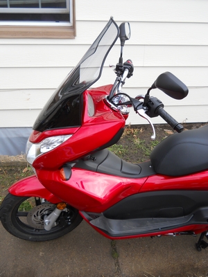

Some days ago I installed a Fabbri windshield, made in Italy, that I purchased online from an eBay seller and here you have some pictures:
I purchased it from here:
http://www.ebay.es/itm/FABBRI-PARAVENTO ... 35dbc509d7
And the total cost was 45 euros + 28 euros (international shipping) = 73 Euros total
I'm 1.85cm tall and after modifying my seat I sit 7 cms higher, and even like that, it protects my whole torso + my chin, getting air at eye level, so I assume that it would work for most of riders. The hands are protected ;)
I was interested in the higher GIVI windshield, but they still do not offer it for the 2014 (in Europe) / 2015 (in the USA) model, so I decided to purchase this one until I can purchase the highest available one. I will think about adding a kind of "spoiler" to the end of the windshield, to get a little more protection in winter. I'll keep you posted ;)

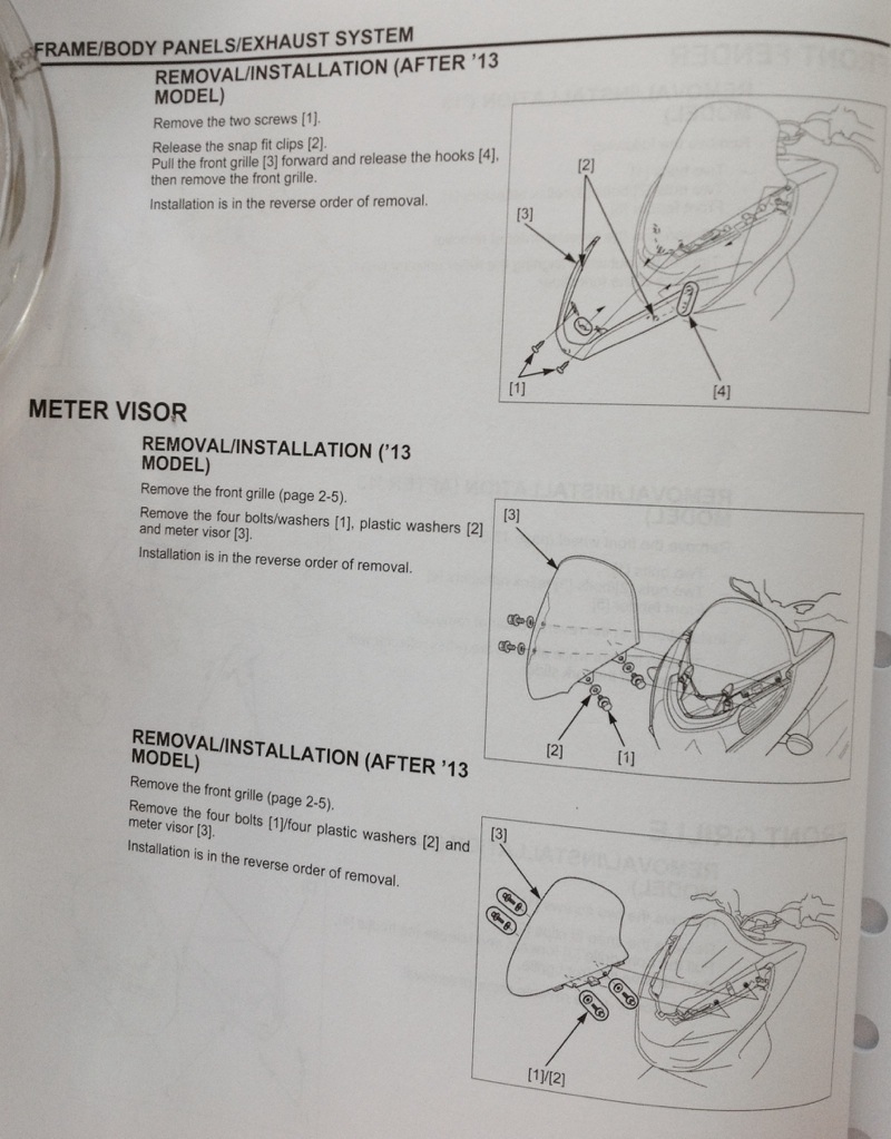

PCXade wrote: 1. How easy is it to fit - when ordering it online?
At first I was following the old model PCX's instructions and I could not dissasembly the original windshield.... I asked in the forum, and forum users Iceman and WhiteNoise helped me, posting the 2015 model instructions:
2015 panel removal 01.jpg (206.45 KiB) Viewed 12558 times

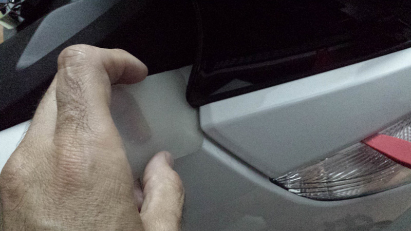

Which definitely helped to remove it! I thought that would be useful to place some "plastic removal tools" here:
So that I could introduce a piece of soft plastic in the upper part of the front grille, and then pull it forward:

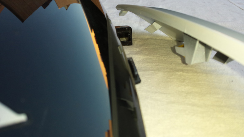

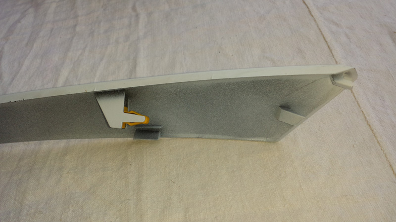

After having dissasembled the front grille, I think that placing the plastic removal tools would not be necessary. Here you have some pics of the different panels, so that you can see that the yellow "snap fit clips" get inside the squared holes in the windshield. You just need some determination to remove the clips from the square holes:
Once you have installed the aftermarket windshield, notice that there are no "square holes" where the "snap fit clips" fit, so it's only a matter of removing the two Phillips screws (number 1 in the instructions) to be able to release the "hooks"(number 4 in the instructions) easily removing the "front grille" :D :D :D :D :D :D
PCXade wrote:2. How much of a REAL difference does it make to wind and rain interference and is it really a great boon in the winter? If I got one.. I would like for November to March perhaps but then remove it - if easy enough.
I have installed in all my scooters a taller windscreen, and I can assure you that I would not purchase a new model if there wasn't a taller windshield available!! When it rains, the pilot only gets wet in the stop lights, as when moving, he/she is protected "inside" the air bubble that forms the windshield ;)
I have not caught rain with this one, but I'm sure that works as all the taller windshields. I will update the message when I get some water 8)

JoshM wrote:How's the wind protection on your hands? Does it divert the air past your hands? That was the worst part of riding in the Winter... my hands would not stay warm enough with even heavy gloves.
PERFECT! I have driven the scooter without gloves, and I feel no air in my hands, and the windshield effectively diverts the air in the whole hand area :D :D :D :D :D :D :D
When purchasing a new windshield I wanted to have my hands protected, as my old aftermarket windshields in other scooters had them, and I am not dissapointed with the Fabbri's design in this matter. When I remove the hand from the bar grips to the outside, I can clearly feel how the wind begins hitting my hand when I get passed the "bar ends" (the metal part that protects the bar grips and attenuates the vibrations)

Yes, I'm very happy with the screen, but in order to be able to turn the handlebars to the maximum and being able to lock it, it must be not very wide, and because of that it does not protect as much as it should...
Speaking about locking the handlebars, I installed some mirror extenders and it works jusr fine ;)
It protects very well the hands in winter and after 2 years I'm glad that I purchased it. Maximum speed with the scooter is about 110 km/h (speedo information, not GPS). When I have some time I'll extend my message on the computer (I'm on the cell phone) with more pics and information :P

I could lock the handlebars, but I had to change slightly the position of the handlebar loosening the 8X32 bolts (with an allen wrench) that hold the handlebar to the lower holder of the triple clamps. This way, with the extenders, I have a better vision of what happens at my back and I don't need to reposition the handlebar.
Given that I added some extra foam to the seat, I seat about 7cm higher, and therefore I needed some extra height in the windshield. I accomplished that by adding a kind of "home made spoiler" to the fabbri windshield. Here you have a couple pics of how it looks:
This screen works very well and is not too flexible. Even with the added spoiler, if I hit a pothole, or when I am driving behind an 18 wheeler, it does not vibrate too much, and I have about 3,000 kms by now. If I had to choose a new windshield today, I would have a look at the newest highest Givi, which was not available when I got the Fabbri one. I don't know which of the two is higher, though? ;)
