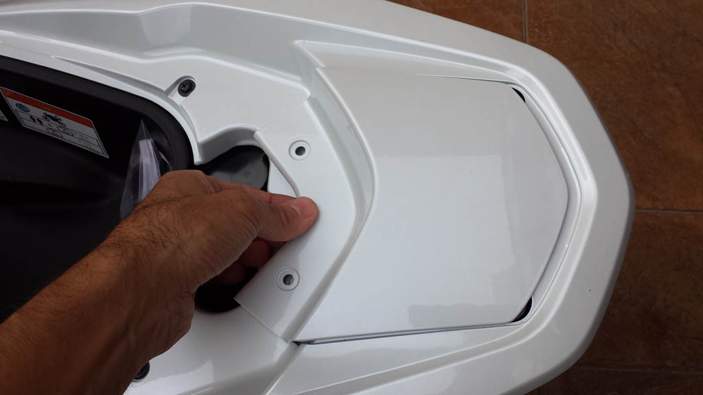

You have to press in these trim clips with something pointy. I use a small allen wrench
And then you take out both trim clips
You take the “lid grab rail cover” and move it towards the front of the scooter:
A little more, and then you can release it:
This is how it looks when it’s removed:

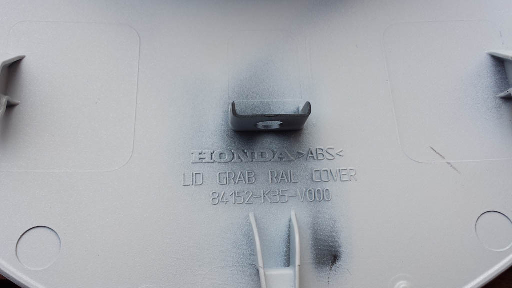

And some pictures of the “lid grab rail cover”:
In this step you can choose to drill the “lid grab rail cover” and install it in the scooter or not:
• If you drill it, it will look great, but when you sell the scooter and you remove the trunk, you have to let the rack installed, or the exposed holes will look a little weird
• If you do not drill it, you would simply store it, to reinstall it when you sell the scooter, and it will look “untouched” and the new owner would choose to install a trunk or not.
I have decided NOT to drill it, so it will look like that:
