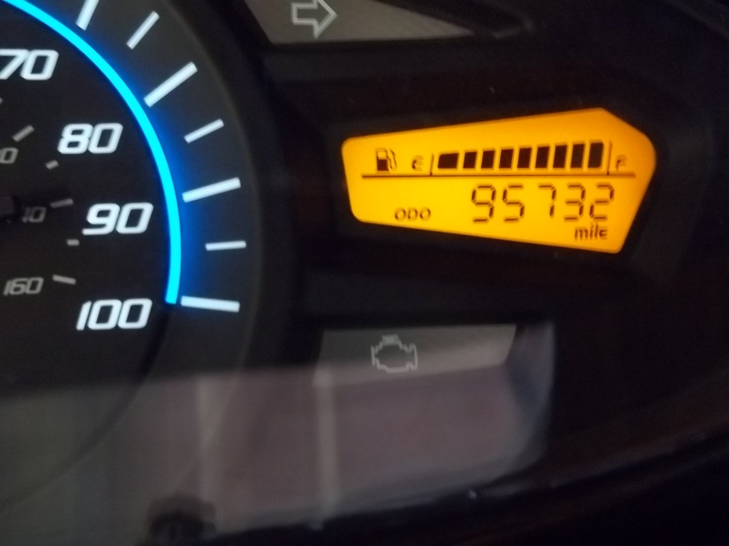

How many miles on the bike?
I have over 7k miles and never had to adjust the valves once. Spot on at 6k.

by mymitzi
Re: Worsening oil leak leads to valve check
Posted: Sat Mar 15, 2025 9:15 am
by Conelite
95k Miles? HOLY HELL!!!!
I think you got your moneys worth lol. Never seen a PCX with over 50k.

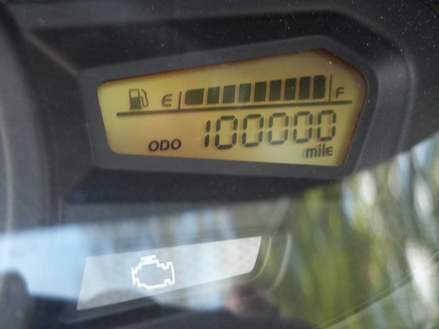

Well Guys, Old Faithful made to 100k. [Had 2,092 miles at purchase] Still running fine. Over the years, have had around 2 dozen Motorcycles, and
enjoyed each one, but the PCX is my favorite. Have a Forza too......fine scooter, but the PCX gets the miles. Honda got it right. Except for the valve
check interval. : )
