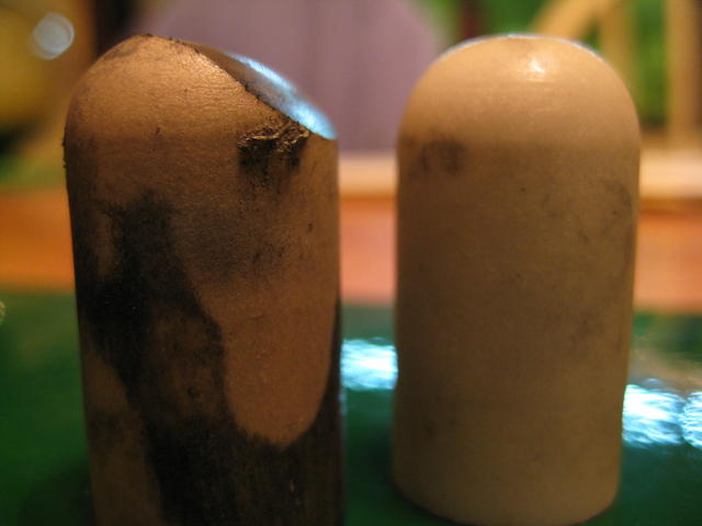

The JCosta variator does not have rollers, it has weighted "bells" that have to be replaced with JCosta branded bells, which are "available," but I have never seen for sale before. They have to be changed every 8000 miles, which makes the JCosta seem rather uneconomical to me (for my mileage, I would have to change the bells every year and a half or less). Here's a pic of a worn bell after 7500 miles vs a new bell:
J_Costa Roller Wear.JPG (34.08 KiB) Viewed 8307 times
If you couldn't find the rollers anywhere, you'd have to order a new variator every time your bells wore down...
