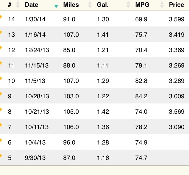

Mpg has been declining. Have done nothing new and driving the same way. It's at 2200 miles

looks like your mpg is in contrast to the $/Gallon.
Have you changed brands? Do you fill up the same (side stand/centerstand) each time and to the same amount up to the neck?
Also, the chart shows the farther you go between fillups, more mpg....same routes/roads?
As khaosaming stated, the temp makes a difference also.
I would add altitude, but I don't think that would be a factor in your area.
Also, you might check the tire pressure since it is colder. You could be running a bit lower and not enough to notice it just eyeballing it.
Have you made any performance mods? Anything done at the 600mile checkup that may have changed it?

logepoge1 wrote:Have windscreen but had it for over 2 months
Between Nov 5 & 15? Windscreen stopping the wind and larger surface area.
A small drop in mpg, but maybe you started driving a bit faster now that you are having less wind hit you?
