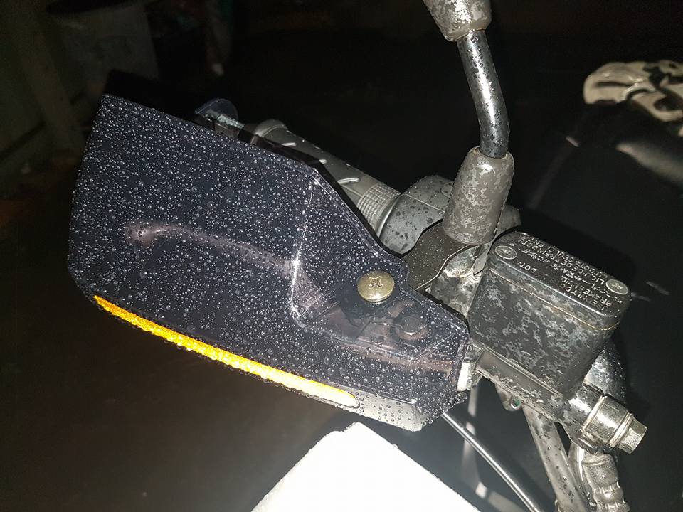

Had this problem, gave up for over a year as any kind of screw bit (philips 3 I think) or mechanical impact driver failed - we even twisted a bit quite badly trying to budge the screws and began to chew them up a little. A few weeks ago I got them off easily by drilling the screw heads off using small to large drills in an electric vari-speed drill - start at 2mm and go up say 3, 5, 6 and maybe 6.5 to get the head off.
No damage to the bar end and the heat from the drilling was enough to loosen the red loctite - never even needed a small blow-torch I bought for the purpose of heating the remaining screw end up! This is the best way and takes 5 minutes each end and the bar end just pops off for easy remaining screw removal. This is a pic of someone else's bike as they just fitted the same bar-end guard I did (£10 delivered off Ebay in smoke, black, red or blue) and stops a lot of the wind chill
Replacement stock bolts (allen key this time!) are M6x45 (40mm thread length and 5mm head) but to fit these you would need M6x55mm bolts.

btw - these can be found by searching Ebay for 'universal hand guards' and stock bolts are csk (countersunk) but to fit these you would need cap head bolts.

Note - the pic I posted above was someones elses install of the hand guards (did not have my phone on me at the time) - they fitted the brake lever support bar on top of the little adapter/extender whereas I fitted mine directly between the brake lever and the extender bar. They also added a small extension at the bar end - I did not do that as there is no need - they clear the levers and I can engage full lock with them fitted.
