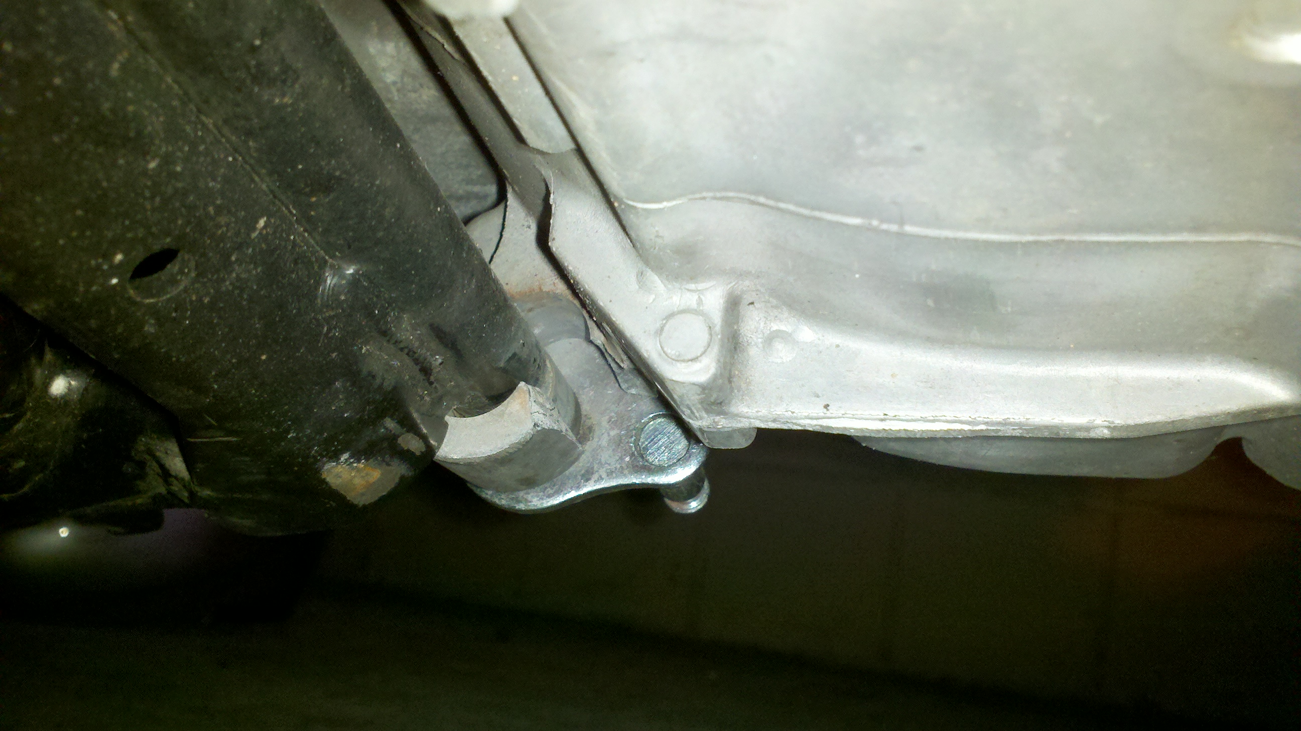

I parked on the center stand today, and it just popped right off. The mounts on the bottom of the engine block broke on the muffler side. o_O
I'll see if I can get it replaced under warranty at the local Honda dealer... I'll need a new engine block though...
I will go take pictures in a bit and post them up. It's quite disappointing, I expected better quality from Honda.

Stopped by the dealer, he took pictures and submitted a claim to Honda USA. They'll have to replace the engine block, which will take 10 shop hours and involve completely removing the engine...
Here's a view from below, you can CLEARLY see where the mount broke off.
I should add a note here, the scuffing you see on the black part of the centerstand is where the stand itself sits against the engine block, and is not from an impact.
I've bottomed out the plastic once, but never the centerstand. I'll keep you guys updated how Honda handles it... I'm hoping they just replace it no questions asked, even though it will potentially cost them quite a bit.

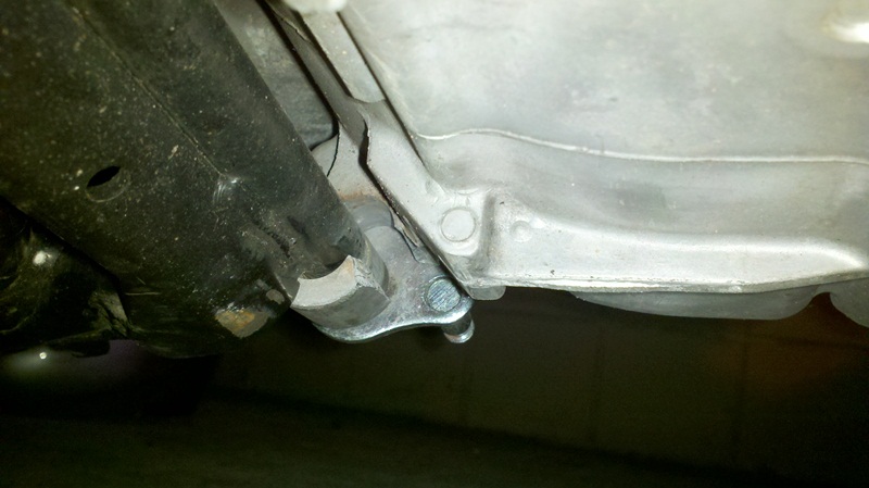

I didn't realize how HUGE the other image was, here's a smaller version:

ask yourself, have i been sitting on the bike while it is on the center stand? have i rocked back and forth to roll forward off the stand while sitting on the seat?had a passenger on the back while doing these procedure's? i've been a owner rider for 50 years and the quoted procedure's are no-no's.
Paul :o
Re: Center stand FAIL
Posted: Fri Jan 27, 2012 4:45 am
by al69
ptmcd1 wrote:ask yourself, have i been sitting on the bike while it is on the center stand? have i rocked back and forth to roll forward off the stand while sitting on the seat?had a passenger on the back while doing these procedure's? i've been a owner rider for 50 years and the quoted procedure's are no-no's.
Paul :o
On my cbt we were told not to do this as the break off on most scooters.They just arent strong enough to take the strain the guy was saying and its common mistake beginners make too.
Posted: Sat Jan 28, 2012 3:53 am
by TC3
Rolling the scooter of the stand while sitting on it is something i do with the PCX. It is a habit i got into when i got my first scooter 9 years ago. I only did 1000 miles on that before getting a bike but now i am back on scooters i certainly wont be taking the risk anymore.
Good luck getting it sorted
Posted: Sat Jan 28, 2012 4:21 am
by gn2
So long as you take your weight on both your feet on the ground while you rock it off the stand it should be fine.
It's sitting with both your feet on the running boards that causes problems.
