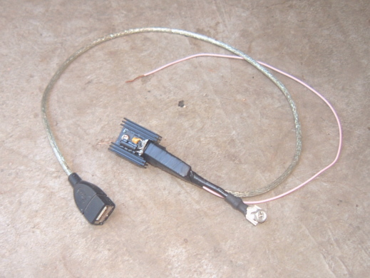

I made and installed USB charging point on my PCX150 this morning.
Ingredients:
  • USB extension cable from old computer.

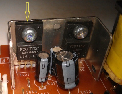

    5V regulator from old printer (see photo below).
    Small heatsink from old UPS
    2 capacitors and some wire.
Finished product:

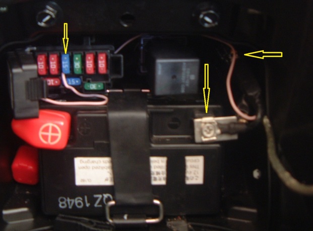

Connected +input to the headlight fuse so that it is only on when key is in (arrow on left).
Connected -input/output to negative terminal on battery (middle arrow).
Pushed circuit into the space shown by the arrow on the right.

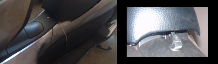

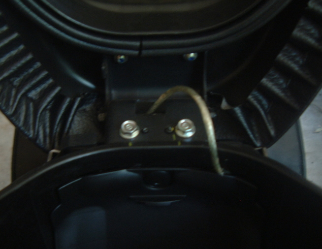

Closed battery compartment and fed socket through the perfectly sized hole that Honda considerately put there for me:
Closed seat:

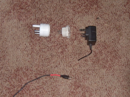

I fitted the leftover USB plug (from the extension) to my camera charger cable so I can charge it from the PCX.
Also no need for the bulky power supply and adapters anymore - besides, we have more USB ports in our house than 220V mains sockets.
