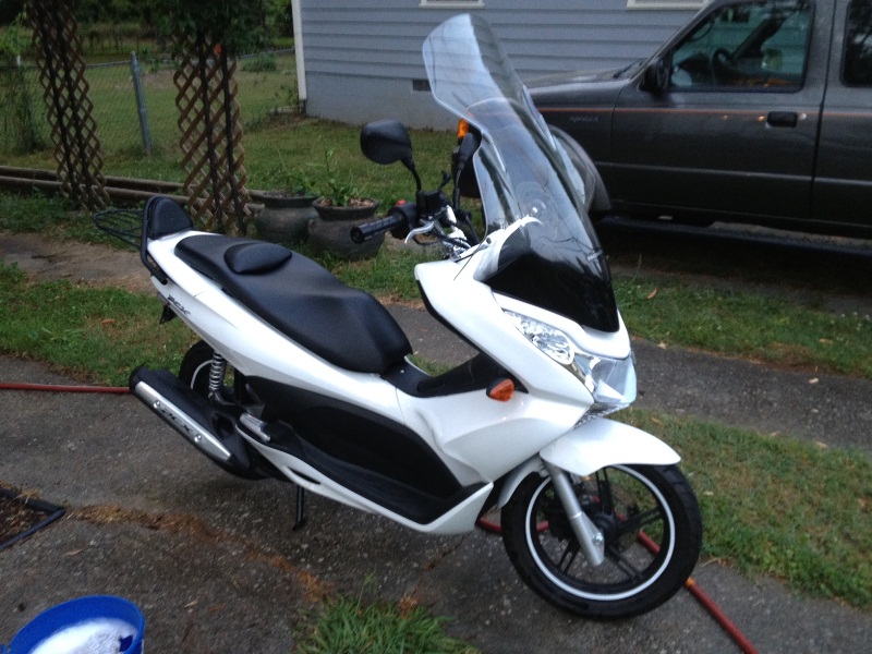

I hadn't taken any pictures of my bike in awhile, but it got a bath last night, so I figured I'd take one:
Still shiny. :lol:

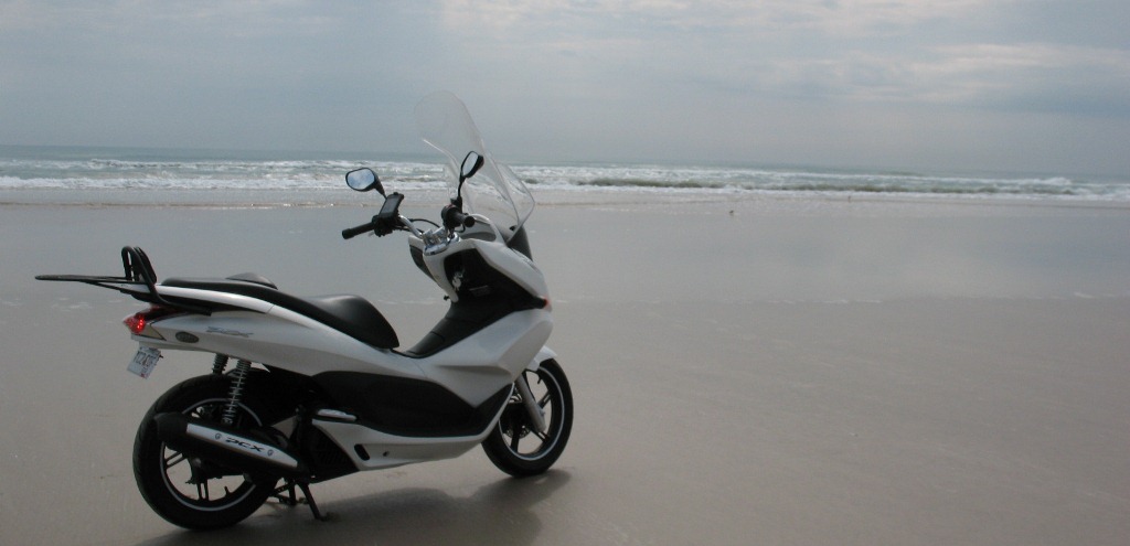

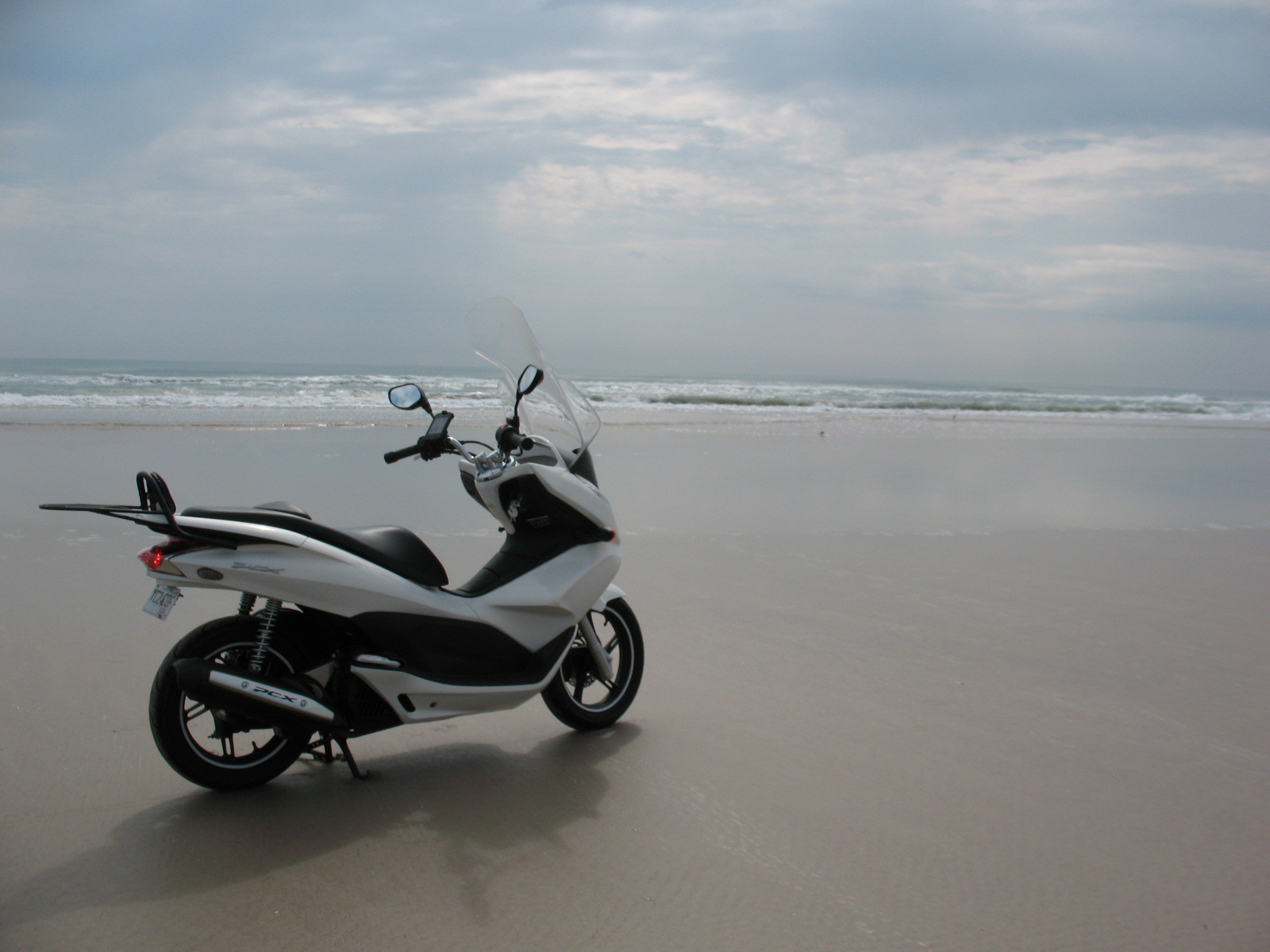

Went to the beach last weekend, the PCX got some sun:
Higher res:
