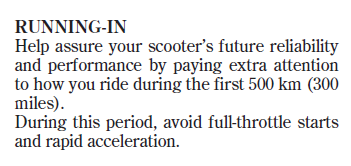

Make sure to vary your throttle constantly during break-in, and avoid long periods of full throttle.
Modern engines come mostly broken-in, here's all Honda has to say about break-in on the PCX 150:
I've heard lots of people getting 5-10 more mph after the first service. YMMV though.
