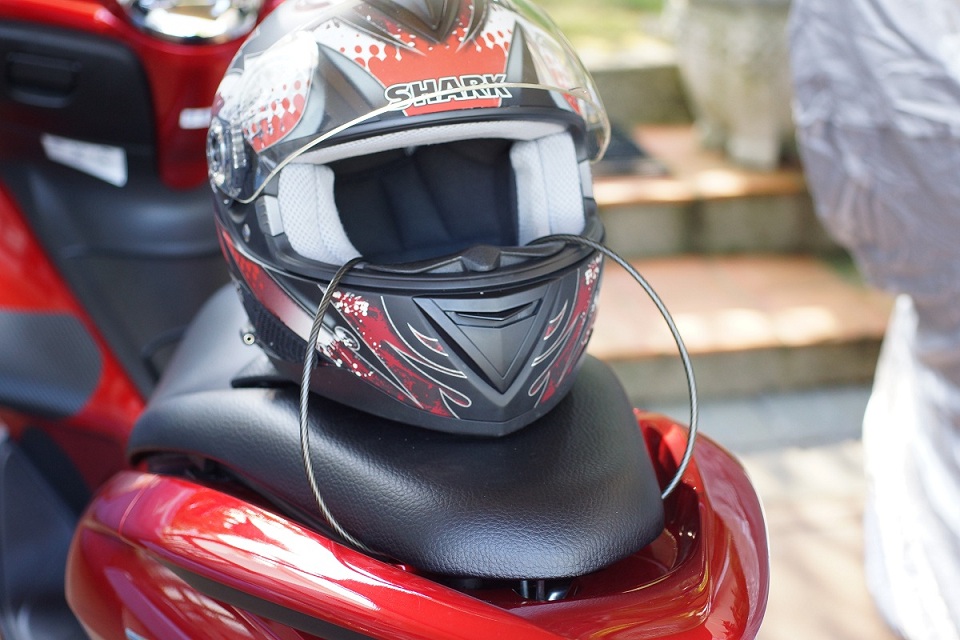

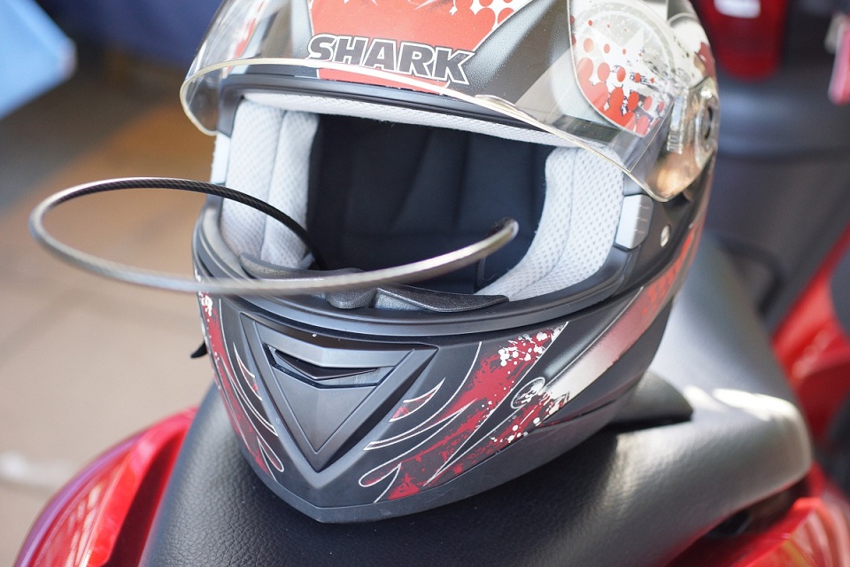

I decided to make a convenient helmet cable lock that uses the two bolts securing the seat back rest to the seat so that the helmet can be secured through the chin piece using the seat latch. Helmet sits firmly on the seat and the visor can be in the down position preventing the padding from getting wet if it rains.
This is the end result:
0 - Helmet Secured.jpg (247.76 KiB) Viewed 4825 times

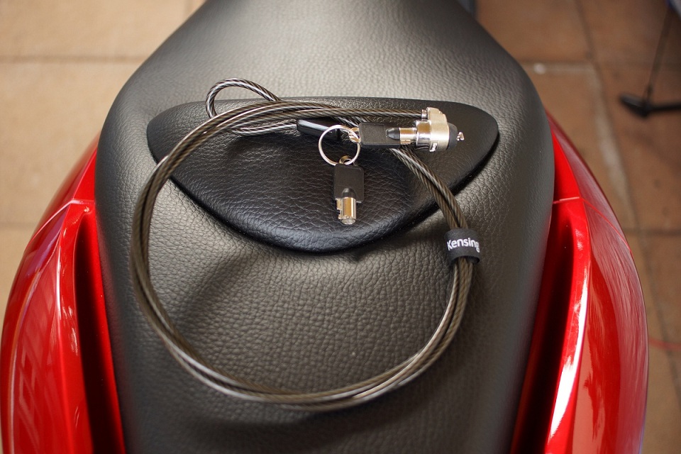

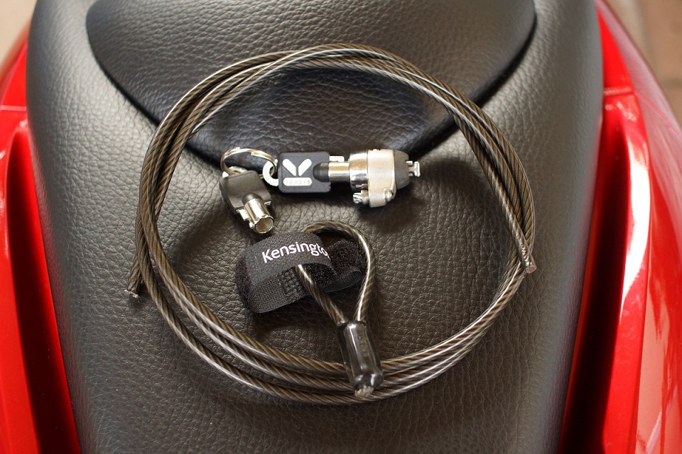

Bought a cheap laptop cable lock over the internet. Cost me all of $2.00
1 - Laptop Cable Lock.jpg (231.63 KiB) Viewed 4825 times

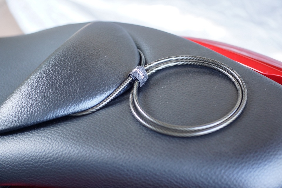

Cut the ends off the cable lock as I only needed the cable. Used an angle grinder with a cutting disk.
2 - Laptop Cable Lock (cut).jpg (281.5 KiB) Viewed 4825 times

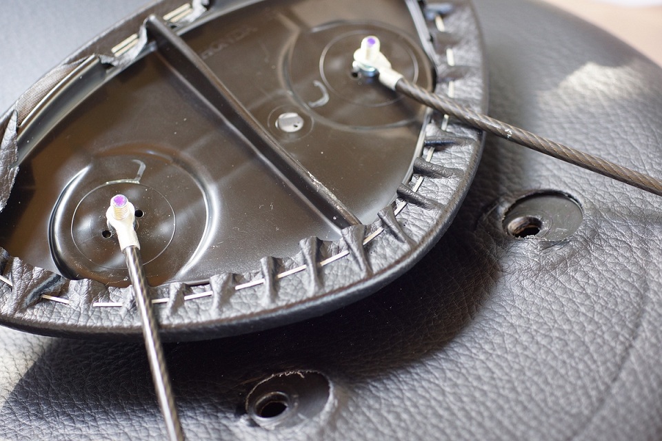

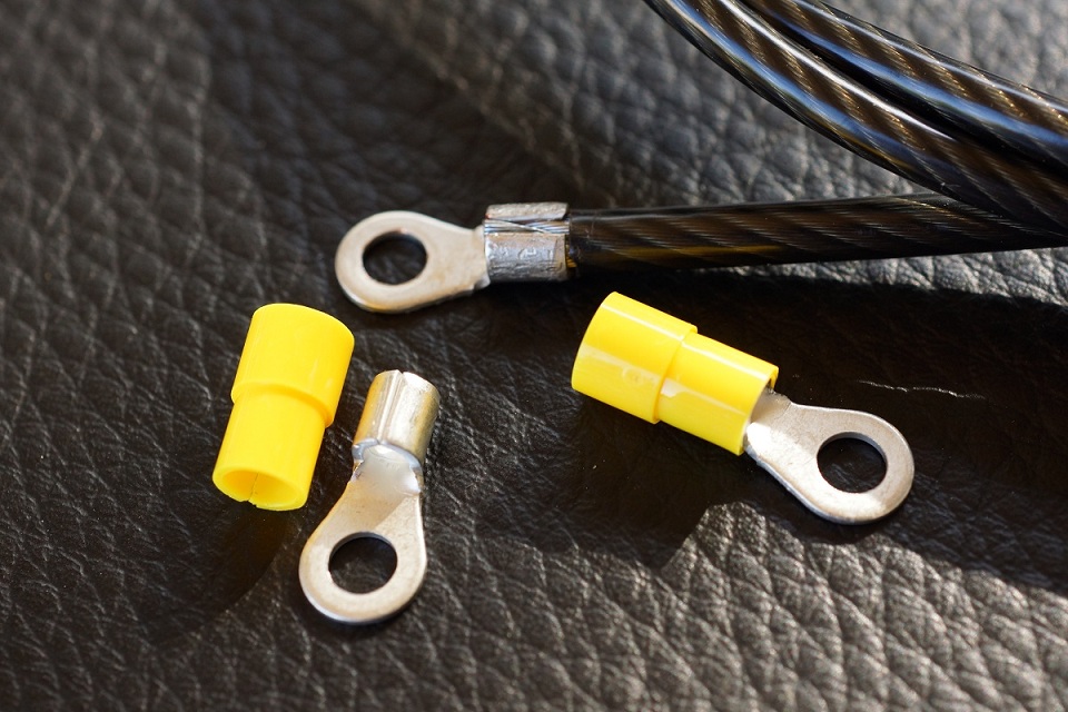

Bought some ring connectors from a local electrical store, the type used for SLA batteries. Discarded the plastic sleeves on the connectors. Stripped the plastic cover off the cable and inserted the cable into the connector and crimped. (I had to cut off more cable to enable a snug fit when the helmet was secured).
3 - Ring Connectors.jpg (238.92 KiB) Viewed 4825 times
Remove the back rest from the seat and insert the ring connectors into the bolts on the back rest.
4 - Ring Connectors On Backrest Bolts.jpg (257.76 KiB) Viewed 4825 times

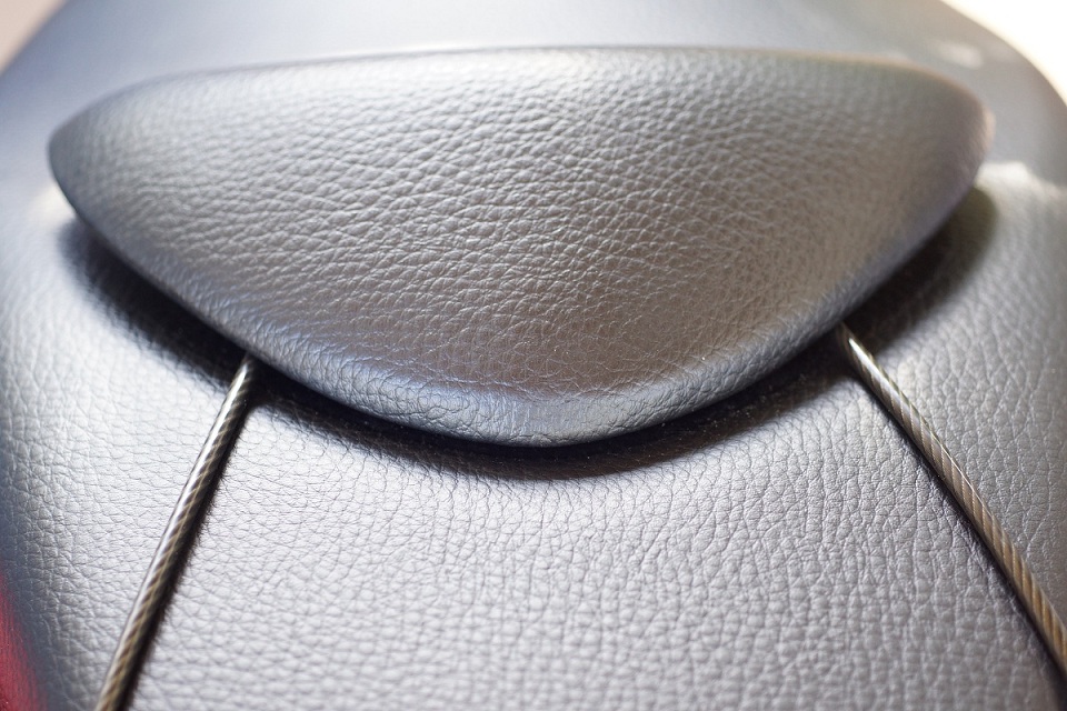

Replace the back rest with the cable protruding from between the seat and the back rest. Replace the two nuts & washers under the seat and tighten.
5 - Backrest Refitted.jpg (265 KiB) Viewed 4825 times

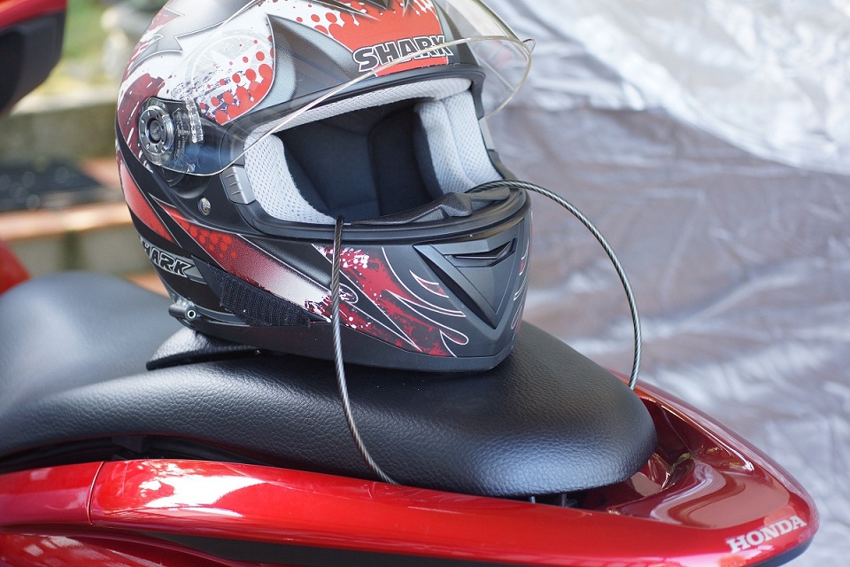

Thread cable loop through helmet.
6 - Cable Through Helmet.jpg (225.34 KiB) Viewed 4825 times

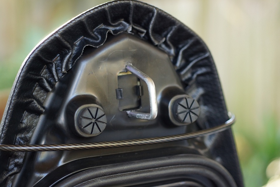

Slip the loop over the end of the seat past the latch.
7 - Cable Around Seat.jpg (194.82 KiB) Viewed 4825 times
Latch the seat. Helmet is secured.
8 - Helmet Secured.jpg (219.97 KiB) Viewed 4825 times

How secure are those crimps?
Looks like they would pull out really easily.
If you had a cable with loops at both ends like this one you could pass the hump bolts through them.

Hi gn2, I couldn't find crimps large enough so settled for these. I guess the cable lock isn't going to stop someone intent on stealing the helmet, merely a deterent. Certainly will rebuild these when I find larger crimps. Thanks for reminding me that the cable lock isn't totally secure.
