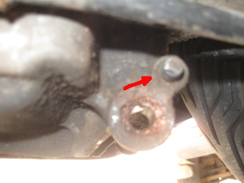

First, remove the split pin and washer.
Keep the washer, discard the split-pin.
(ok, ok, I know the stand is down, I took the pic before I started)
Next, push the pin out until it is flush with the engine casing.

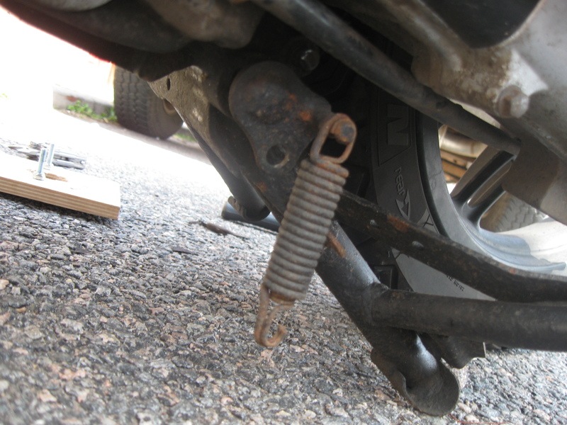

... and the stand falls down:

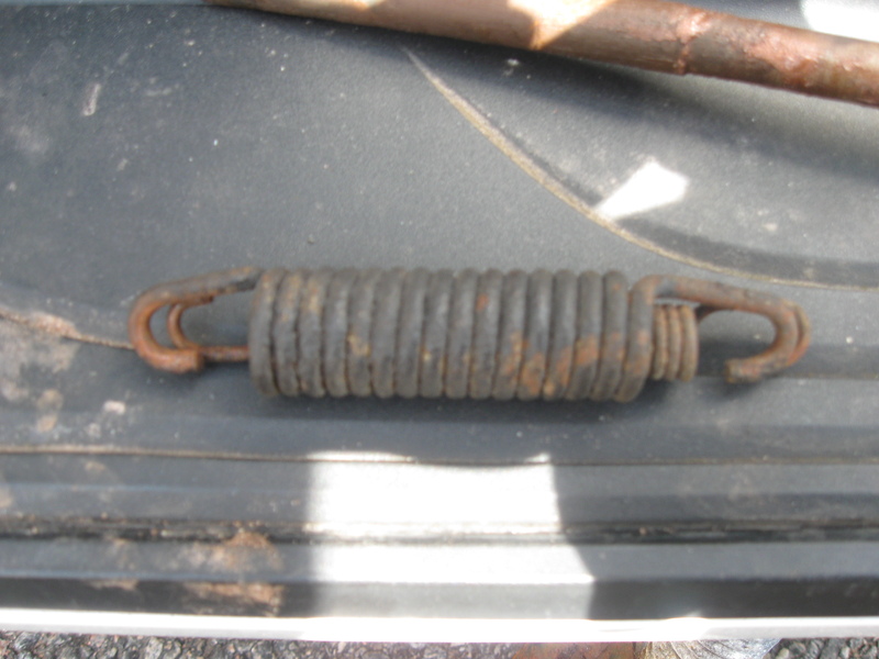

Note that the spring has two concentric elements which form a loop at the pivot pin end and a hook at the stand end:

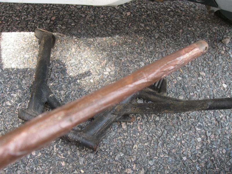

Withdraw the pin by getting a hold of its endplate and wiggling it out.

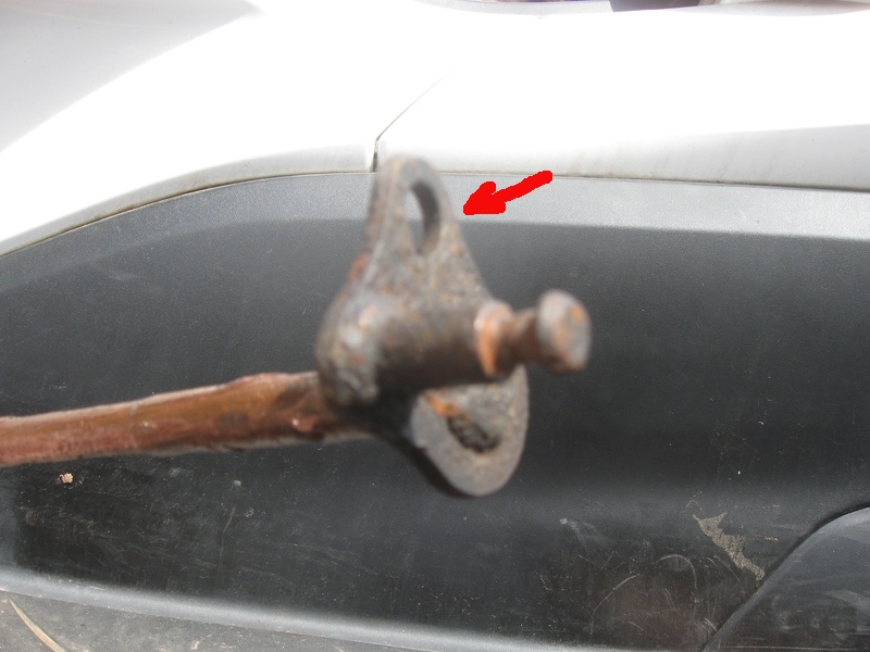

Once you have the pin out, give it a good coating all over with grease:

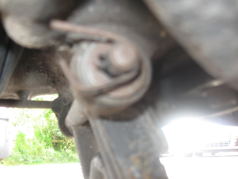

Note that there is a pin projecting out of the crankcase which locates in the hole in the pivot pin end-plate:

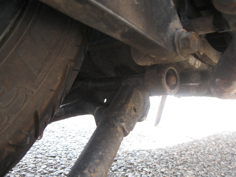

Insert the pivot pin through the mounts and centre stand pushing it fully through with the endplate over the crankcase pin.
Replace the washer and fit a new split pin to secure the pivot in place.

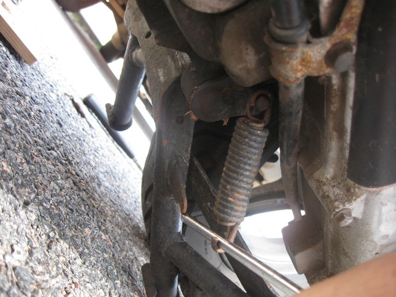

Put the closed end of the spring on the pivot pin and put the hook end over the phillips screwdriver with a notch of the cross in the end of the screwdriver like a V on the tang on the centrestand:
Next, holding the stand fully up with one hand push back on the screwdriver stretching the spring which will slide along the screwdriver and into position in the notch in the stand.
Make sure both halves of the spring are correctly located at both ends, wiggle them into place with the pliers if necessary.

Man, you've got one rusty scooter. many miles in bad weather I suppose. How old is yours and how many miles have you racked up? No offense, nothing you can do about it. Thanks for the lesson, appreciate all the help on this forum.
Re: Centre stand pivot lube
Posted: Tue Jul 09, 2013 4:42 pm
by gn2
That's it after a clean and some bits repainted...
Bought in October 2010 it has seen three Scottish winters and currently on 16,000 miles.

One thing I found with using the phillips screwdriver, was to lever it slightly down further than the height of the peg on the centre-stand. This way the spring is more likely to want to slide back up the screwdriver onto the peg - a small bit of grease on the screwdriver helped here as well.
