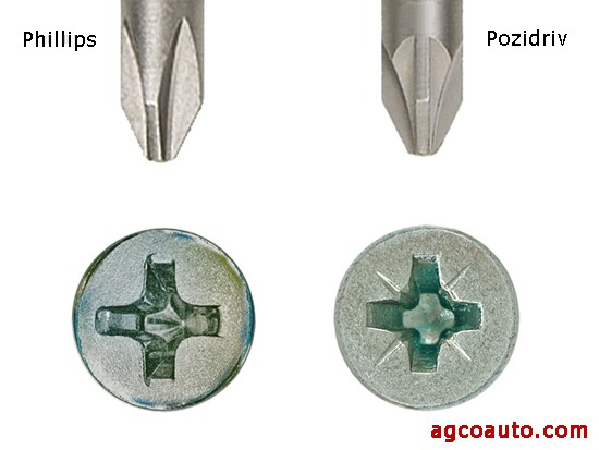

Never heard them called cross head screwdrivers before. Most places I've been call them Phillips head.gn2 wrote:It's a key area of maintenance and is probably the achilles heel of the PCX.
Well definitely two of them.
I might do a how-to on this one because getting the spring back on is either really easy or really difficult depending on whether you know a little trick with a crosshead screwdriver...
Re: Bike Maintenance
Phillips was the guy who invented the crosshead screw.
Not all crosshead screws are Phillips ones though.
