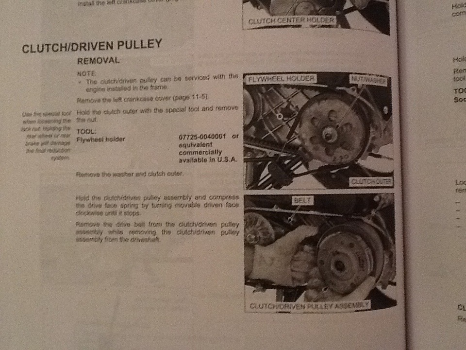

Look at the manual they use a fancy looking strap wrench. It's only tightened to 49nm you know what's it like. Things are sometime tighter to remove than they should be. If I was at work I would use an air gun. It says not to hold it with the brake or rear wheel or the transmission could be damaged.

- ImageUploadedByTapatalk HD1370894794.209839.jpg (207.47 KiB) Viewed 5118 times

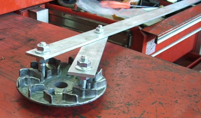

I made one of these. It works fine on the variator but haven't tried it on the clutch.
- ImageUploadedByTapatalk HD1370983702.811338.jpg (69.8 KiB) Viewed 5037 times
Re: Clutch nut
That looks like it would be OK on the clutch.
One of the key differences between the clutch and the vario is that the clutch doesn't have the bolt holes for the holder.
