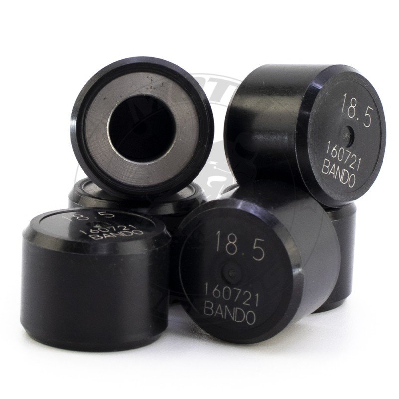

So stock the pcx had 18.5g rollers. I've been running 14.5f rollers. So the 10g rollers that came with the kit are way way to light especially with a heavier spring fitted from the kit too then. So should I try and find some heavier rollers to try in the polini variator. I've found some 19mm x 17mm polini 15g rollers so should I try them or will they not be light enough now I have the heavier spring fitted up. Just really annoying that I'm having to try and find rollers now to try and get the kit to work. Polini arent replying to my emails so I'm trying to sort a return out for it now unless I can get it working

Mon-Eye wrote: Wed Mar 20, 2024 10:10 am So stock the pcx had 18.5g rollers.
I believe the European PCX comes with 15g weights as the riders are heavier than Asian riders. who get 18g. If you want to know how much your original weights weigh put them in a self-addressed envelope go to the post office and ask how much it costs to post. They will weigh it. 8)

Standard UK model 21 22 came with 18.5g 22123-K1Y-J10 from honda. Hondas new replacements are now 19g for some reason. I'm run in standard honda belt too as not be recommended any alternatives and seams to run ok
