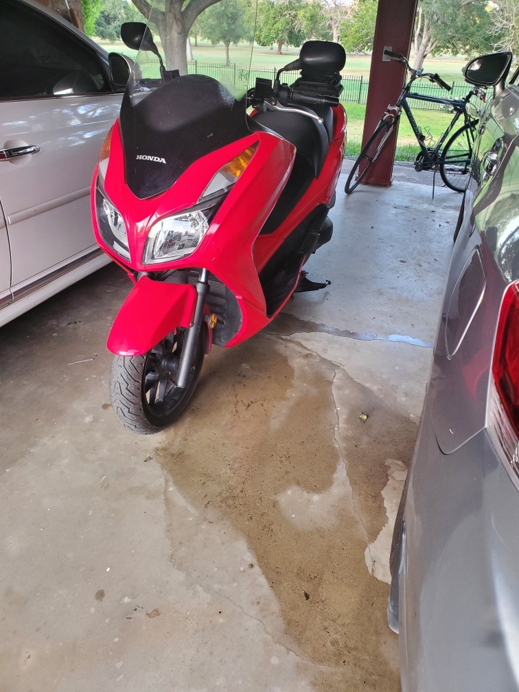

After riding my Forza 40 miles to a Honda dealer to have the recall done, they forgot to order the part. They did agree to pick it up at my house when the parts came in a couple weeks later.
I was a little concerned after all the lousy service work I’ve experienced lately, just in general with bike shops, and auto shops, but didn’t have much choice.
Got the scooter back Wednesday and it ran fine. I put about 10 miles on it around town. This evening decided to make a grocery run. Found a huge puddle of gas under the scoot in the carport. Argh!,,,,,!!!!.

This is what it looked like the next day after getting it home from dealer.
Sent it back and just as I suspected, their parts department forgot to order the gasket (O ring), so the mechanic tried to re-use 8 year old gasket.

Good luck I had this job done about a year after I bought mine new and ended up with the same result you did. I found a puddle under the scooter a couple of hours after I got home. They came and picked it up because I told them I would not ride a bike that was leaking directly under my rear tire. I picked it up a few days later got home and kept an eye on it for leaks. The next morning no leak so I rode to work. A couple of blocks from work when I hit the gas to leave a light the bike almost went out from under me because unbeknownst to me there was a big puddle forming under the bike in front of the rear wheel, exactly the concern I express on the first failure. Gasoline is very slippery! Again I made them come to my job to tow the bike, this time 20 miles away. Third time seems to have worked. But get this several years later I get a notice that it's do for a recall in spite of the fact that I had it done TWICE. I haven't brought it in yet, I'm more afraid of having another "repair" done than I am of the recall.

It turns out the parts guy didn’t order a new O ring. Mechanic tried to re-use the 6 year old one that was on the pump.
