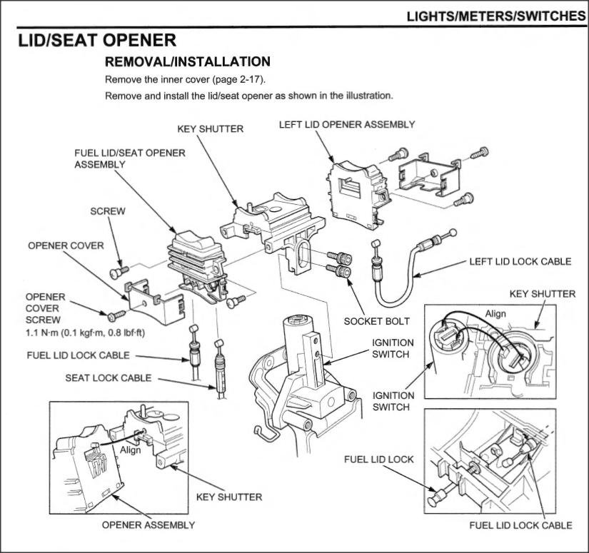

It is a mechanical switch pulling cables. Not electrical.

It certainly feels like an electrical switch operating a solenoid. You can hear the solenoid kick. If it was pulling a cable, it would be much stiffer.

edtheconfessor wrote: Sat Mar 19, 2022 6:30 pm It certainly feels like an electrical switch operating a solenoid. You can hear the solenoid kick. If it was pulling a cable, it would be much stiffer.
It is mechanical. This is the page from the service manual - 2016 Forza
Snap 2022-03-19 at 22.04.27.jpg (109.74 KiB) Viewed 20143 times

That is a nicer diagram than I have, Thanks.
Re: Fuel opener/Seat Opener Switch
Posted: Sat Mar 19, 2022 10:53 pm
by davenowherejones
It appears the centering spring is in the switch. I will just have to jiggle the switch to get everything in alignment. No big deal.

Very sorry, the action is very precise for a cable operation. So sorry!
