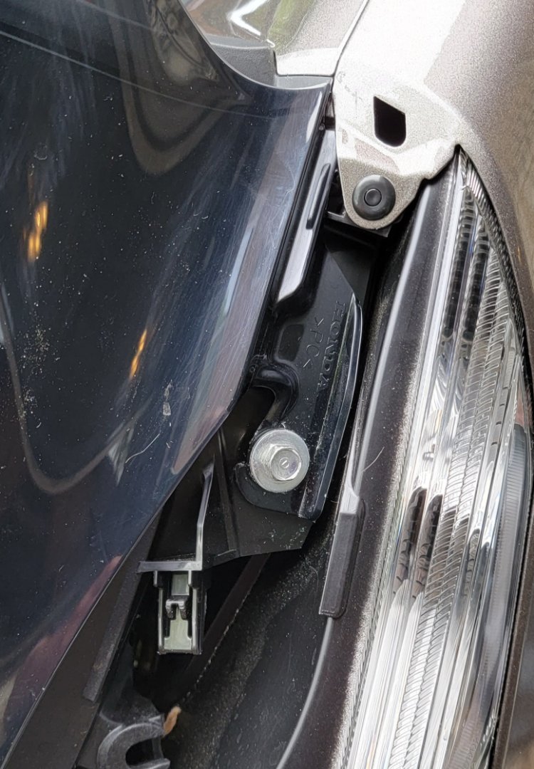

So I was attempting to install my tall GIVI windshield and thought it would be pretty simple as I watched a couple videos and had a general idea of what to do. I was able to pry off the plastic V shaped panel without too much drama. I somehow kind of screwed up one of the mirrors when I was removing it because I was confused by the two bolts.
However, the main issue I had was trying to remove the stock Honda windshield. One of the 10mm bolts 🔩 I must have turned it in the wrong direction and screwed it up (pun intended) Now the bolt spin indefinitely along with the two washers in either direction. A contractor friend who is very handy took a look at it and he believes that threaded insert which the bolt is in is damaged/loose which is why the bolt keeps spinning.
What do you guys think is the best way to resolve this issue?

Reluctantly taking a shot at this..........hope there is a better way.
Maybe hold the bolt with locking pliers and drill the bolt through. Get another bolt [smaller/thinner] and nut.
Since the threaded insert is turning also......Maybe it could be held by small locking pliers?? Might have to remove
other parts to get pliers in there?? Maybe there is another member out there with a better solution.
Hope you get er done.
Re: Stripped 10mm bolt
I can't guarantee that this will work but you might try this. Get a thin flathead screwdriver. Try to insert it under the washer. Then, while using a ratchet to try to unscrew the bolt (counterclockwise), keep pressure on the straightslot screwdriver and the ratchet so that the head of the screwdriver is forcing the bolt head up while the ratchet is forcing the bolt against the screwdriver. With enough pressure you might be able to unscrew the bolt one turn at a time.
If that doesn't work you may end up doing this whole thing the hard way, so take your time as you turn it.

I ended up talking myself out of the Givi tall windshield (and necessary mount kit) and just returned both items. Honestly though, if I'm riding at anything under maximum speed the wind really isn't that overwhelming anyway. I appreciate the input though guys
