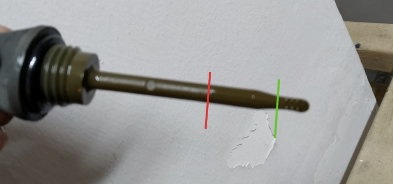

Is this too much engine oil?
Post by 150pcxer »
Checked 15 mins after switching the engine off after coming back home.
What should I do to remove some of it?
The last engine oil change was done by a junior mechanic at the workshop.
Could there have been damage done to the engine?

Still too blurry...where’s the oil dry/wet line?....If it’s where I think it is, yes it’s way too much oil. It should be down on the little small part of the stick that’s x’d out
Pull the plug and let some out. Also remember you don’t screw it in to check it you just let it sit on the top of the threads, not screwing it in. That may be your problem if you screwed it all the way in to get the reading
Have you read how to check the oil in the manual?

Definitely way too much. Buy a 1000ml Measuring cup. Drain all your oil, Measure it and reinsert exactly 1000mls. Shouldn't take much more than 10 minutes.

150pcxer

Are you sure you’re not screwing it all the way in and using all the threads and making it tight, or are you just sitting the stick on top of the threads and not screwing it in?

Maybe the bike was not level when the oil was drained and not all drained out. If this is what it reads after you added 800 and the dipstick is just inserted to the threads (not threaded in) ..... then this seems a bit high but not horribly so. You're supposed to measure it when the bike is hot .... if it's hot and level and measures too high then you can take some out with a sight tube / straw I guess.
To get a true reading, get the oil hot and bike level. Then remove the dipstick and first wipe it clean and then re-insert the dipstick centered w/o swiping the case threads or threading it in - pull it back out and get the reading. Basically, a quart of oil will suffice to drain and refill BOTH the final drive and the engine.

Re: Is this too much engine oil?
Its overfilled but not by a huge amount.
Its not ideal but won't cause any damage. If it bothers you use a small syringe and pipe to remove the excess.

I went to the mechanic and got the old oil all drained out. I personally tilted the bike left and right to ensure the old oil drained out completely.
Then I told the mechanic to put in exactly 800ml of fresh new engine oil. I brought a measuring cup with me for him to do it in front of my eyes.
Got the engine started for 3 minutes, left it off for another 5 mins. When I checked the dipstick, it still showed the same oil level again, it was still way above the maximum line.
I've placed an order for a new, stock dipstick then I'll see how it goes.
