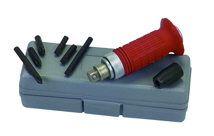

You can always use an impact screwdriver. The brake levels on a HOnda Ruckus are 10x harder than the ones on the PCX. Impact screw driver works like a charm. I personally had zero issues removing the ones on my PCX when I changed handle bars. Use a good quality screwdriver. Preferably one with a T-Handle if you have one.
These are less than $10 at harbor freight. No need to pay top dollar for something you rarely use.
Screen Shot 2021-02-15 at 8.28.04 AM.png (388.96 KiB) Viewed 4984 times

I like that impact screwdriver. Next time I'm at HF, I'll probably grab one. A T-handle will be good add to the tool box. This one didn't need it, but I was glad to know what to do next if I ran into trouble.
I soaked the screw in PB Plaster. I gave a few taps on the screw too. I found a bit that fit really well and use a ratchet wrench for good leverage in lieu of the T. Thankfully, I no issues nor even the slightest slip getting the screw loosened.
