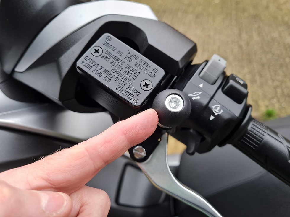

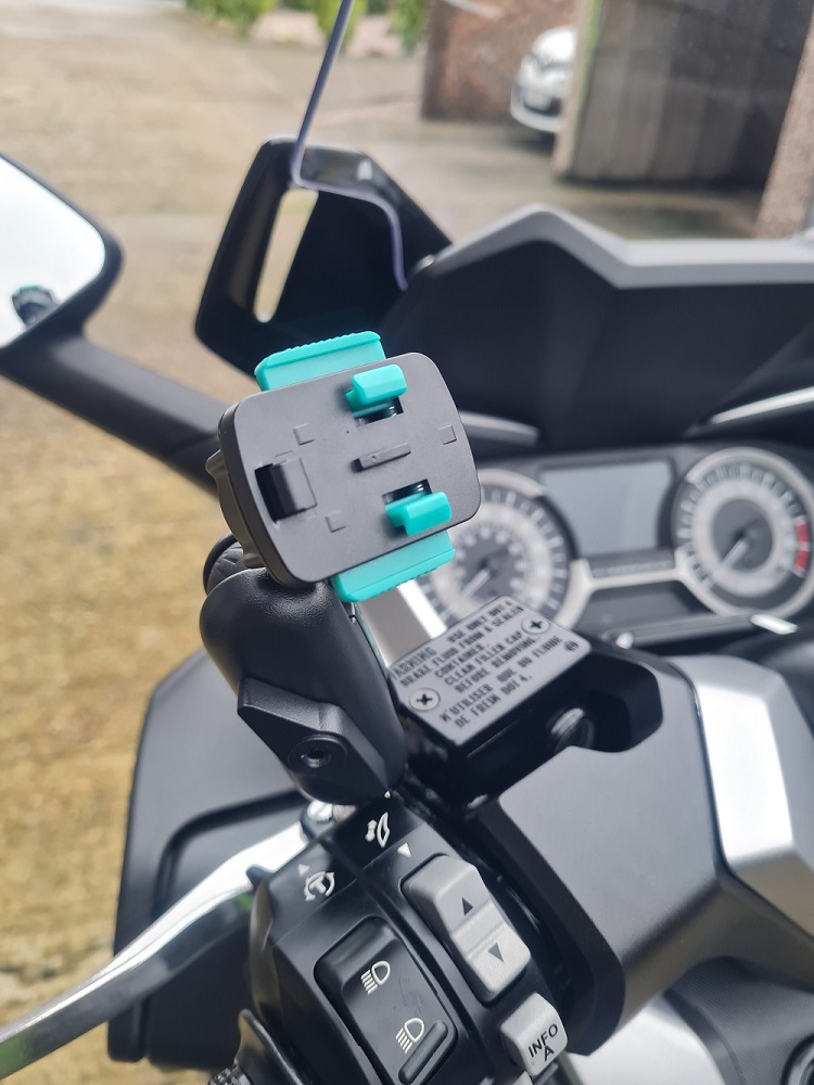

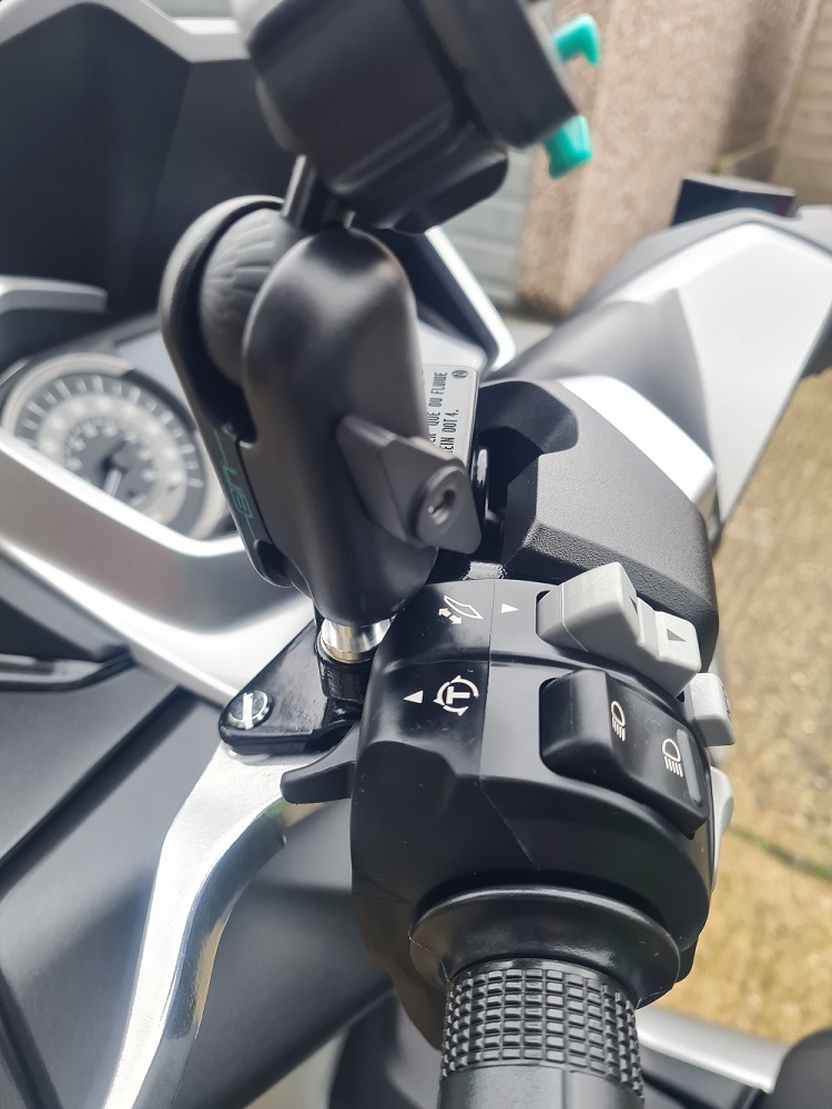

Here you are, minute job..

Didnt need to take anything off, I just used the unused mirror mount on handlebar by the rear brake lever.

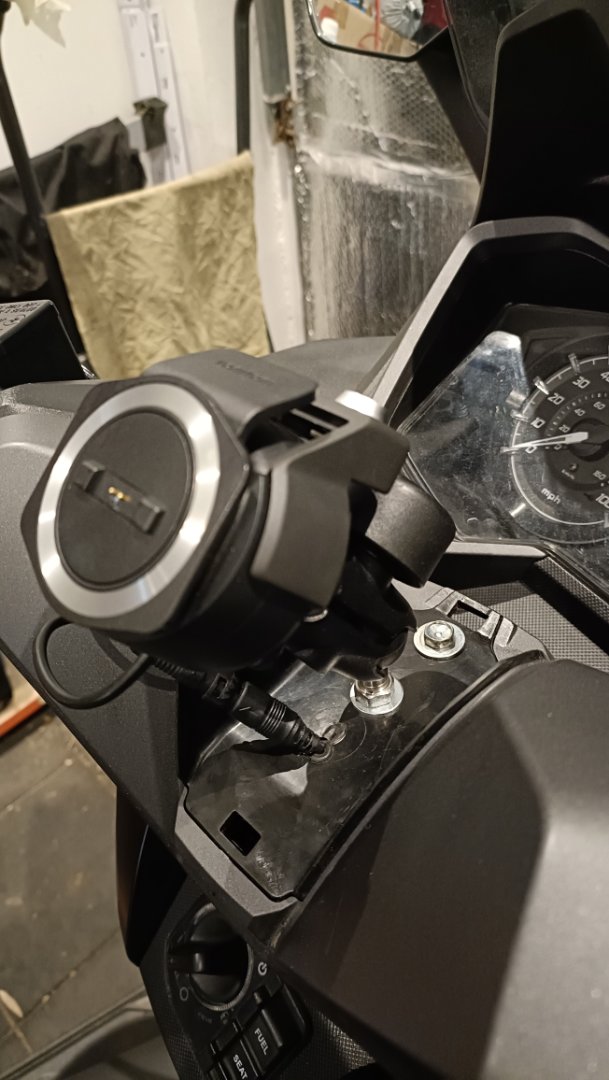

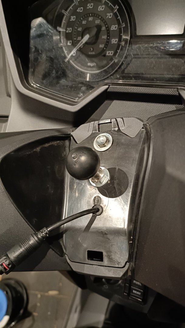

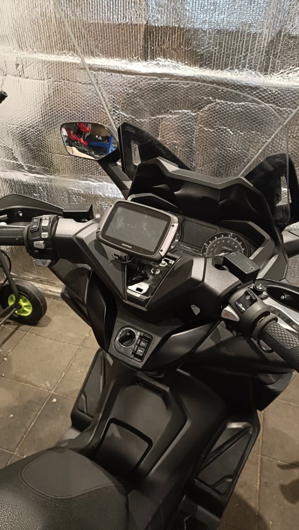

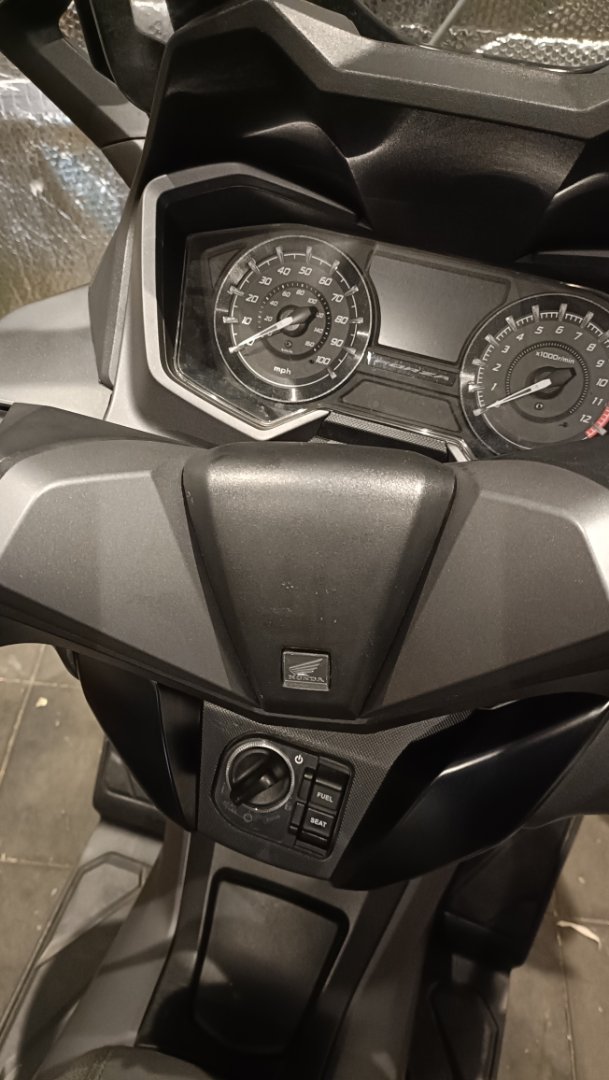

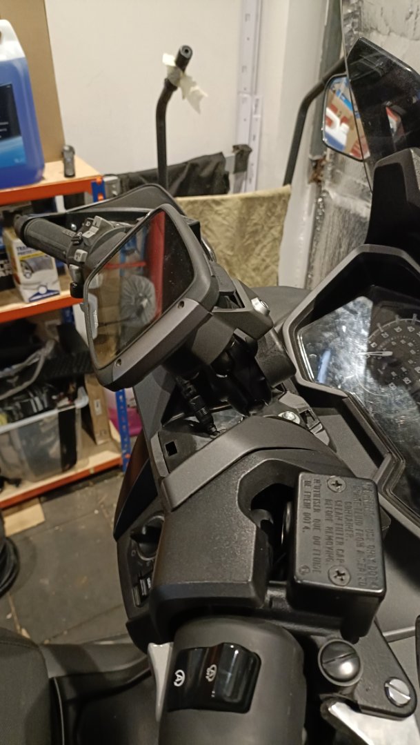

I've just mounted my sat nav on my new Forza 125, but prior to that, was looking for mounting suggestions on YouTube, etc. Everything I found seemed quite convoluted or required adding a lot of clutter. Anyway, I noticed there was an unused female thread in the centre of the handlebars, underneath the central plastic cover, which is very easy to remove and put back again.
It seems to have been overlooked by all the various YouTube how-to's I watched.
Turns out, it's an M6 thread, so I just bought an M6 threaded Ram ball mount from Amazon. Drilled a small hole in the plastic panel near it to thread the power cable through it - job done. Neat, along my central line of sight, and the best part is that when I'm not using the navy, the ram ball is small enough to allow me to replace the original plastic cover so you would never know it was there.
This central cover hides everything.
