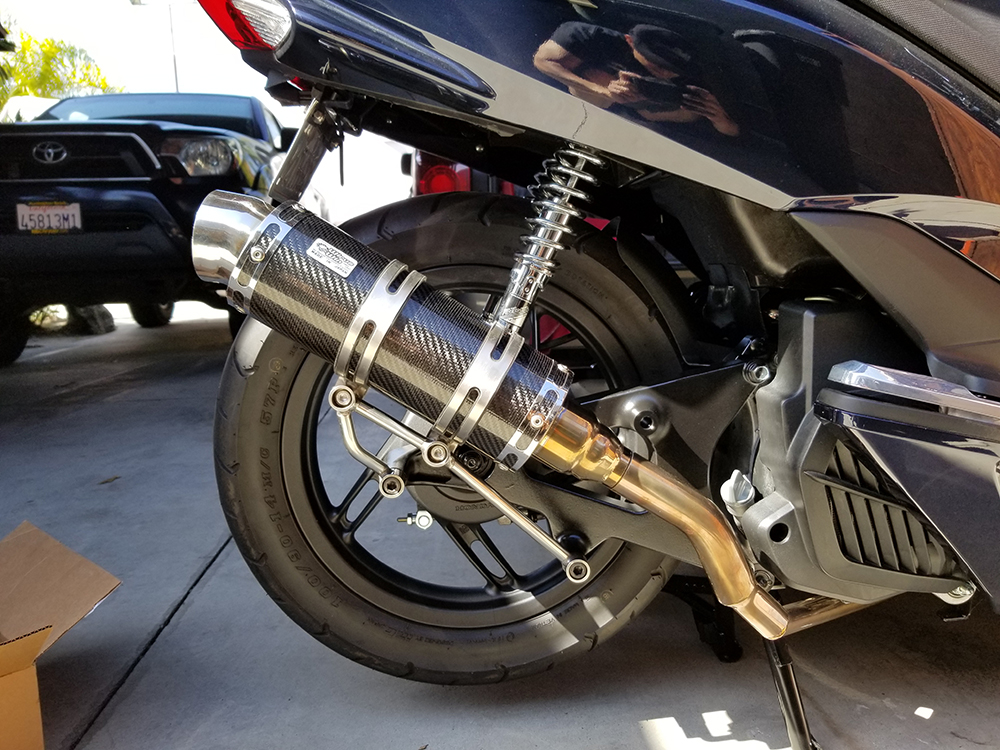

My Wirus Win exhaust with the silencer installed is really quiet. Not stock quiet but its pretty dang quiet. plus the exhaust itself is Carbon so is even lighter than a Stainless one.
Most Japanese exhausts are really quiet given they have strict regulations.

Conelite wrote:My Wirus Win exhaust with the silencer installed is really quiet. Not stock quiet but its pretty dang quiet. plus the exhaust itself is Carbon so is even lighter than a Stainless one.
Pipe routing looks a little low. Does it drag?

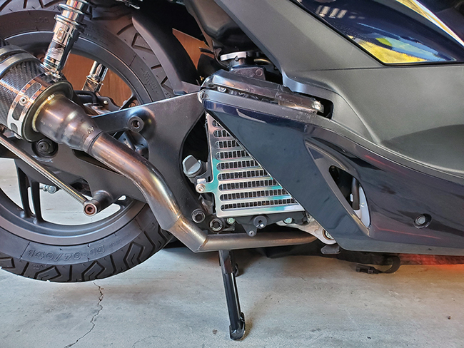

From the picture doesn't have any scratches. + it is a very nice looking exhaust. Do you have any additional photos?
Not even close. It was just a bad angle. I'm going to redo the header since it has that HORRIBLE angle. I have a Yoshi header waiting for the reroute.
