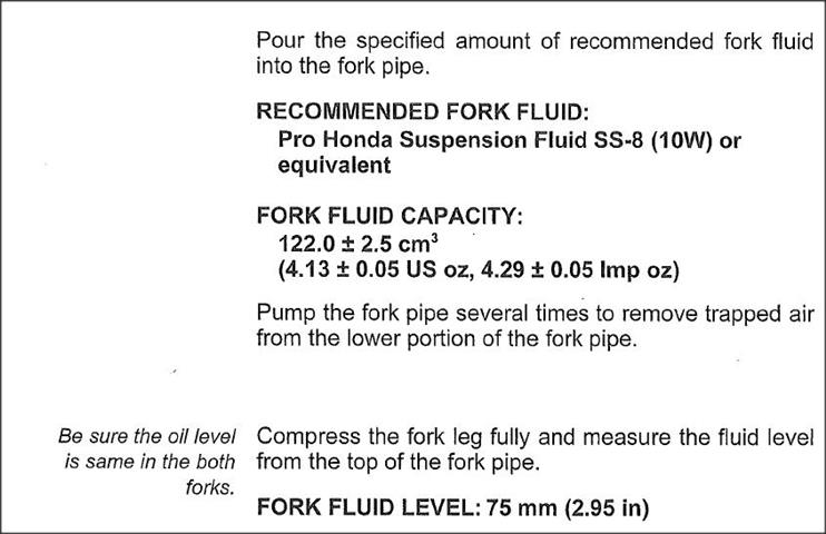

This is from the PCX 150 service manual:
Snap 2020-10-15 at 09.18.03 (Small).jpg (49.28 KiB) Viewed 26214 times

Limey wrote:This is from the PCX 150 service manual:
Nice.

Limey - Thank you for the screenshot! Reading around most manufacturers try to stick to around 100mm+/-25mm from the top. So 75mm probably is right. I wonder if they used the same forks on the 150 as the 125?
I think oil level rather than quantity is the way to go.

FYI - After a little research with the fork part numbers it appears that Honda did infact use the same forks on both their 125cc and 150cc PCX.
SO... Thank you Limey, looks like 75mm is the correct level measurement.
