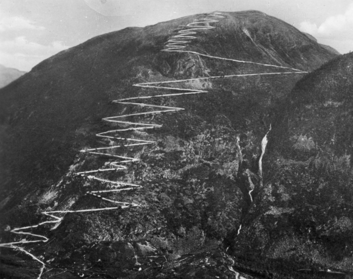

I live in Norway, dealing with roads like this one though.
And I know that's an ancient picture, but the road is still pretty much the same and real easy to see in that image.
Not sure I like how the freewheeling sounds though, might be a point in favor of buying an NC750X instead of the Forza.

That is an extreme road. The Forza would do it easily but I would not want to do it more than once.
I have ridden the NC750X with DCT. I want one. The DCT should always be in the right gear also. I don't know.
The Forza freewheeling goes on and off. It makes a freaky ride. Not pleasant.
I have a similar road to a lookout in Manning Park near me. It is challenging and scary also. I need to do it again before the snow starts again. It is half paved and the upper half is gravel.

I got like 6 locations within 150 radius km which are like that.. ^^ And some of them I need to ride on a regular basis.
With the NC750X though, you can choose gear with levers on the handles if you want to. So you can pick a good one for going down hill.
Are you considering changing your Forza to an NC750X yourself?

Nope, too steep, bends too tight, too often, too far!
A nice 300-500cc motorcycle with a set of gears is what you need.

Is the road paved or gravel?
Winter??? No way.
Summer, hell yeh, just once.
What is the distance from the nearest gas station to the top? Times two.
My Forza can do about 300 km on a tank.

Can you rent a 300cc scooter and try your olympic category slalom course?
Each time you need to slow for those very tight corners - you'll be 100% brakes. Engine braking will have just vanished at that slow speed.
Brake disc warp might pay you repeated visits?
Boiled brake fluid with air, now?
Seriously doubt anyone on here has dealt with roads exactly like your photo!

Norway seems to be 40 segments up, Hedley to Mascot Mine is 28 segments.
I find going down switchbacks a lot more scary than going up. Going up is fun!
Manning Park Lodge to the look out seems to be about 22 segments but they are paved and quite easy to do. The very top is gravel.
The Norway road is incredible. I would do it.

You probably get away with it occasionally, but on regular basis, not a good idea. If you have to slow down to 30 or 20km to go around tight bends the CVT disengages. I have been up and down a lot of hills , but not that extreme and only 10-15min continuous down hill only...
NC750x with DCT is a better option for this job, has auto and nanual gear and more powerful engine for up hill..., just lose to Forza on comfort and room under the seat a bit...
