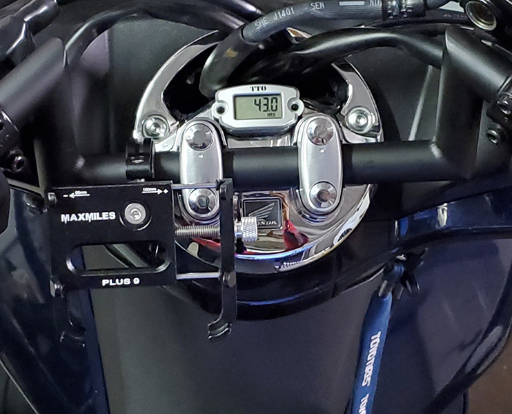

Check your tire pressure. Also look into a tach. TTO is cheap enough and its a simple reference to see what the engine is actually doing.
Another thing to consider is the Drive Boss. I never compared it on the PCX but I know on the Ruckus, different bosses are different length. That plays a huge roll on how much the Variator can move. Compare the 2 and see if there is any difference in length.

Conelite wrote:Check your tire pressure. Also look into a tach. TTO is cheap enough and its a simple reference to see what the engine is actually doing.
Tach also dispays your highest RPM achieved when you switch off.
Which is handy...after a run.
I believe they also have a tach with a CHT - Cylinder Bead Temperature gauge. Easy to install, just uses a thin ring that fits with the Spark Plug’s crush washer. Gives a real time reading of the plug / head temp.

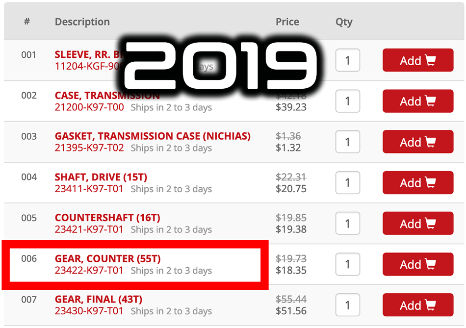

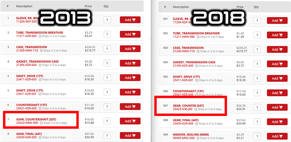

by Conelite
Here is the only thing i found comparing years. This is the gearing set from 2013 vs 2018. Definitly different. Hey look at that, the 2019 is even shorter of a gear.
Now we know. So what you can do is spend less than $100 for a full set of gears from a 2013-2018 bike and gain like 10mph.

Conelite wrote:Here is the only thing i found comparing years. This is the gearing set from 2013 vs 2018. Definitly different. Hey look at that, the 2019 is even shorter of a gear.
Nicely done, look at the final gear for the 2019, it's 43 tooth. So even shorter gearing.
The Kitaco gear kit might work with the 2019 PCX, It's 51T. I bought it for my PCX, but I haven't installed it. I bought it from webike.com .

Would that be the output shaft for the rear pulley? Wouldn't there have to be another corresponding gear that needs changed as well? I've never taken a belt drive machine apart like this.
