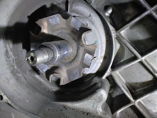

Was doing my regular cleaning and maintenance (every 2k) of the drive parts few days ago when I encountered this weird problem.
The boss is stuck and it won't budge. Iv'e tried using pliers and screw drivers to try and remove it but I failed. Scared to damage something, I sprayed it with WD40 and let it sit for 20 minutes before I tried removing it again, successfully this time.
Iv'e never had this problem before, usually it just slide out easily using my hands, so I'm not sure how it happened.
Anyway, my clutch bearings are now starting to make some noise after almost 4 years and 53,000 kms. I tried re-greasing those bearings but it seems that the damage has been done and the noise won't go away anymore. Maybe it's really just time to change the entire clutch set. For now, I'll be riding with a slightly noisy clutch (audible only during idling).

I wonder if they are frozen together due to corrosion. It should just slide off, but if it is corroded it may be fusing. Try something that loosens corrosion. Maybe WD-40??
Whatever you use will have to set before it will work it loose, so leave it overnight after spraying it.

Yeah, I was able to remove it after soaking it for 20 mins with WD40. Also, cleaned the entire area to remove any chemicals or dirt that caused the problem.
I'm not sure if I'm supposed, but I did put a little grease on the shaft before I insert the boss and the bowl back.

One other possibility that I thought may make it stick is if the engine was hot . . . or you were running the engine to watch the CVT system work with the cover off before doing any work on it. Note that I didn't have my PCX long enough to have to deal with the CVT or belt replacement or anything like that . . . just routine oil changes and oil pump screen cleanings (plus added gear oil to final drive). So I am guessing here.
Heat causes expansion and cold causes contraction.
You said you added WD40 and let it sit for about 20 minutes and then it came off OK. That would have been enough time for it to cool down a bit.
