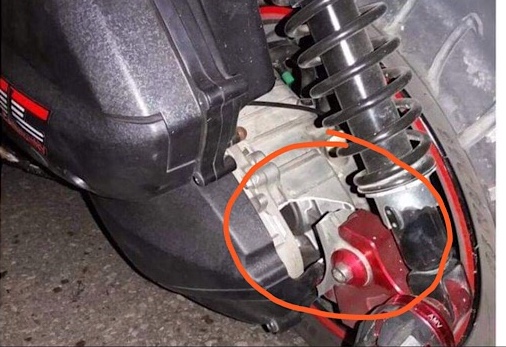

I would be real careful with the lower shock adapters that you have added. This picture was posted on a Adv rider.com...When I saw this, I took mine off. You are no longer pushing down on the crank case as it was designed, you are pulling the crankcase to the rear which the case is not stressed for.
Tnx fore the replay.
I will check it whenever I clean the bike fore cracks.
Maybe I have to find another way to lower the bike.

Yes, by the time you see cracks - it will be too late.

Fish is correct, you will never see this coming. Just take them off, the shocks you have may be able to be shortened thru adjustment , most of the high-end shocks will do that.

Looks great! (Although Jge64's pic is pretty scary.)
