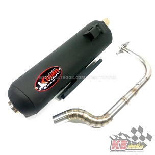

There are slightly modified stock exhaust being sold here in Thai, you might wanna try and find one there. More airflow, a little bit audible than the original, but not loud like the aftermarket ones.

alx123 wrote:That's a good project, but I fear that the capital you will spend might not be worth whatever performance effect it'll have.
example
Thanks for the recommendation. I did a quick google search, but couldn't find it. I found something similar on ebay though.
https://www.ebay.com/itm/Exhaust-System ... Sw5wJb79~b
