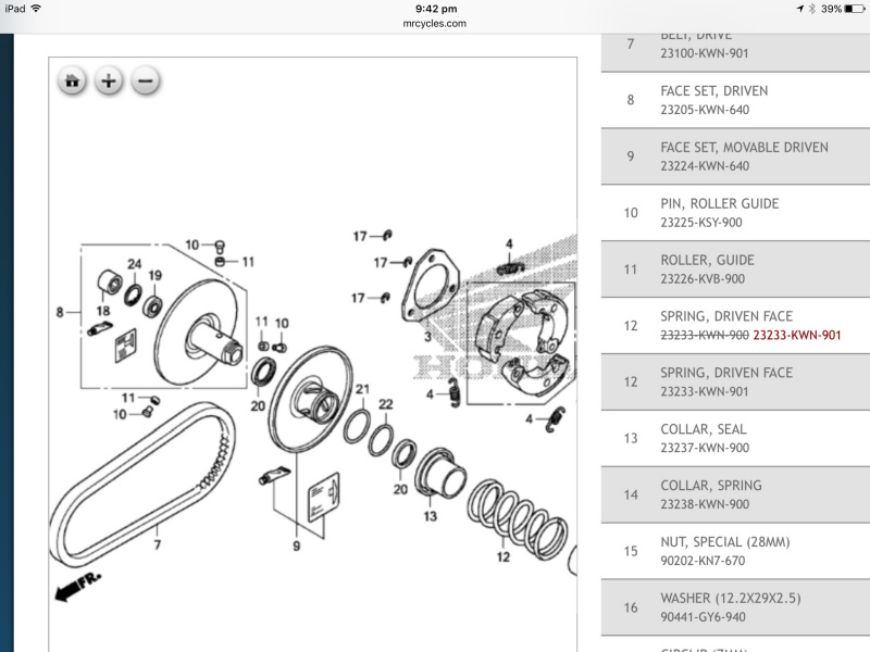

Keep in mind that some of the 2013 models had a problem with the clutch bearings. It is a known problem that Honda has not acknowledged. When they start making a growling noise when you spin the wheel backwards (bike not running and on center stand) then you will know that they are going.
Parts #18 and #19 are the problem. I think someone did not pack enough grease in them.
Clutch bearing.jpg (21.67 KiB) Viewed 4571 times
Replace the entire assembly. It is quicker and cheaper. (Item #8)
