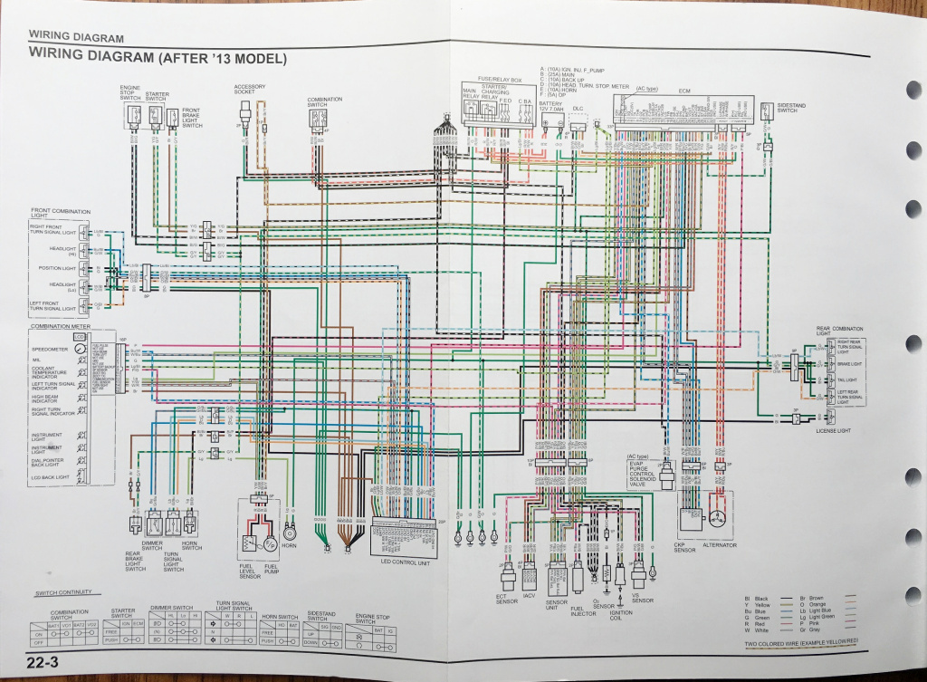

Re: I want to add a turn on-off switch for the lights on a P
Posted: Sat Sep 28, 2019 8:30 am
Hmmm...well, if you must ride with them off, there is a somewhat easy solution, though it may require that you take the bike apart if you can not reach the connector.
Your bike may be a little different from mine. I know that newer bikes use LED lights, but the concept should be the same.
On mine if you look up behind the headlight there should be a connector plug. Unplug it and see if your lights come on when you start your bike. If not, then you found the correct connector.
Note: your turn signal may be connected through this same connector, so you will need to allow for that in your adapter cable.
Once you have found the correct connector you only need to create an adapter cable that plugs into that connector, with a switch between the original plug. If all of that works like it should, just make sure you have enough wire length on the new adaptor to attach the switch to the handlebar.
You only need to run the low beam headlight portion of the original wire assembly through that switch. The turn signal wire can be a straight through back to the other end of the connector.
See if this helps some:
PCX LED-small.jpg (372.35 KiB) Viewed 56252 times
I wish that I could explain it better or be there to help, but this is the best that I can do right now.

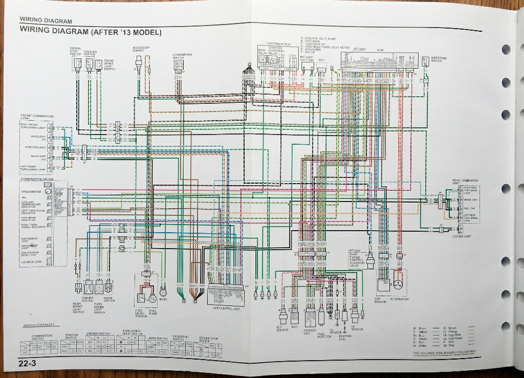

Posted: Sat Sep 28, 2019 9:13 am
In case you can not read that included wiring diagram, I do not know what the position lights are, but the low beam light seems to only need the white and black wire. (Green is always ground on the PCX). I thought the plug assembly would be better because you would know more about those position lights than I would, since my bikes are 2013 models.
If the position lights do not matter, then just cut the black & white wire (not sure if it is white with black stripe or black with white stripe) and put an inline switch in.
I resized that small wiring diagram just now so I hope this copy is more readable.
