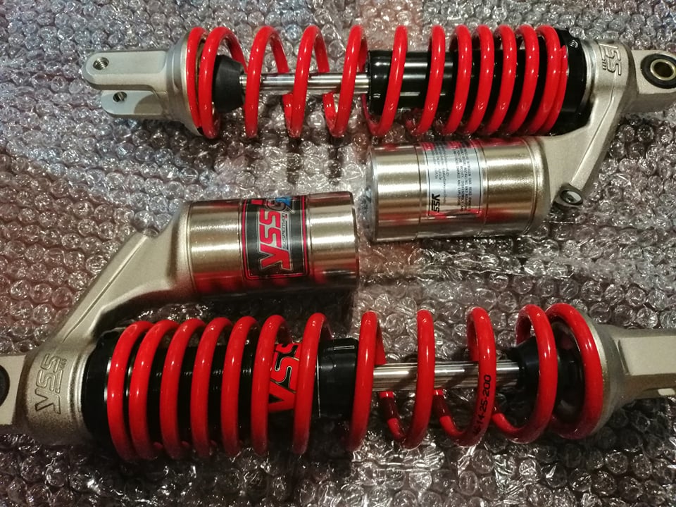

This is the shock I bought

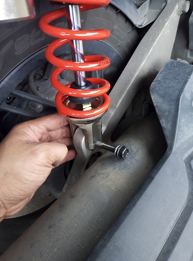

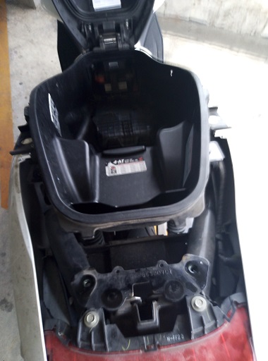

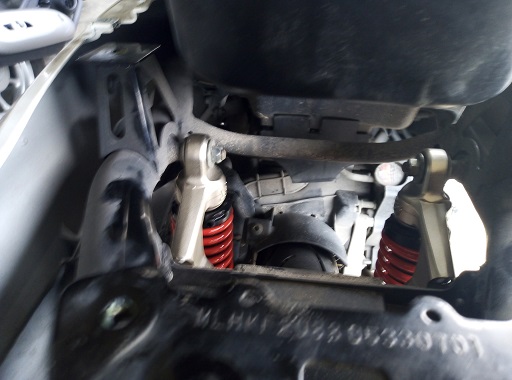

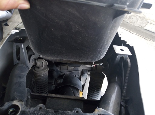

So I did it today and it's not as difficult as I thought it will be.
It took me approximately 1 1/2 hour as I decided to proceed slowly and carefully.
Here are the steps, jusyt like in the video above.
1.Remove the Givi Box, the plate, and its bracket.
2. Remove the rear cover using a screw driver
3. remove the handrails bolts using 12mm wrench
4. Remove all the bolts and screw holding the storage box (10mm bolts)
5. In my case I didn't even remove the storage box entirely, just lift it a little bit and then you will have enough space to remove the nuts on the top of the shocks.
6. Remove nuts (14mm) on top of both shocks, as well as the bolts (12mm) holding the suspensions below. (no need to remove air filter box in 2014-2017 model)
7. Install both the new YSS shocks. Should be easy.
8. You need to remove the bolts (14mm) holding the muffler as it's not possible to re-insert the rear shock bottom bolt of the YSS shock. No trouble reinstalling on the left side though.
9. Once all bolts and nuts of the shocks are tightened, you can now slowly reassemble the scoot in the reverse order.
Tighten muffler > reinstall storage box > handrails > back cover > givi bracket and plate > givi box
Notes:
Rear shock top nuts torque (25 NM)
Rear shock bottom bolts (16NM)
Muffler bolts torque (30NM)
Tools
Wrenches (10mm,12mm,14,mm)
Screw Driver
Hex Key
Torque wrench
Done! and I'm glad I didn't mess up :lol:

After 30 kms of riding today, I can say that I'm starting to like the new YSS shocks. It gave the scoot a different feel when riding;It feels more sturdy and with better road feedback.
My initial impression on it's stiffness is based on the fact that I can feel the road surface imperfections more now. But on bigger humps and bumps, the YSS gives a much cushioned bounce than the OEM shock. When riding with a passenger, it's perfect.
Now I'm thinking of upgrading the front forks next, as I can feel its inferior performance more now. :lol:
The YSS front fork upgrade kit is more expensive than my YSS rear shock though. :o o_O

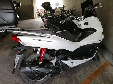

The new shocks in red really look great with your white PCX. :)

Sandymay wrote:The new shocks in red really look great with your white PCX. :)
I believe it added a bit of red variation to the rather boring all black and white.
