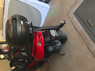

Looks like success!!!

That looks scarey! All of the pulling pressure will be on the upper rack. You need to add a stabilizer bar to the swingarm.

1/8 steel! Easily can handle my little trailer/Kayak combo!

Looks like a lot of leverage from here. I agree with Mel - scary.

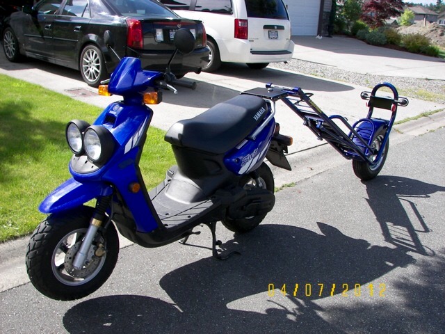

Seriously....Be safe(r), secure that shaft to the scoot. Listen to Mel. I think this is (as they say), "a no-brainer." Hey! We Care

Just found this in my library of pics. Cool! Do we consider this safe?

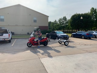

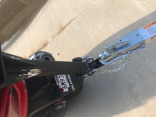

Highway test passed...
