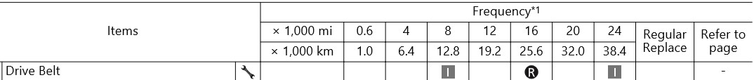

Replace every 24k km according to most PCX manuals. Every 25.6k km for PCX 2019 US.
drive belt PCX 2019 US.jpg (29.79 KiB) Viewed 1700 times
My 2015 PCX is at 15k km. Top speed now is about 110kmh on the dashboard. 2 years ago when it was about 5 months old, it was 114kmh dashboard, but 104kmh on a GPS app on my phone.
I plan to try to replace it myself when the time comes.

raito wrote:Replace every 24k km according to most PCX manuals. Every 25.6k km for PCX 2019 US.

At 7500 miles you have only lost about 4 mph off of the top end. Just ride it until close to final test time. Then decide. At some point you will need to do a GPS test of the speedometer to see how accurate it is, for your own benefit.
Most of the Honda bikes, from what I have experienced, are pretty close, though my PCX is now 5-7% off in the low range and gets more accurate as it moves toward 55 mph, where it is right on target. After I upgraded my variator and drive face it stayed accurate at the topend (now 75 mph).

The belt has to be measured to determine if it is still within the usable limits. The manual will specify the values.
All other methods are indirect and can be unreliable.
