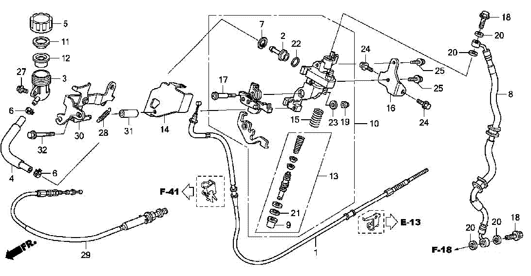

I believe I know where "thebeast" is speakign of.
If you look at the attached photo, part number 15 is the spring that was tweeked. I don't know if this is the source, but he believes it is.
I believe that it could be the spring, or a component associated with the combo break assembly.
If you look up from the front tire, you can see the combo break assembly way up in the top near where the break cables enter the plastic body.
Does anyone else have success with this?

gmlawrence wrote:I believe I know where "thebeast" is speakign of.
