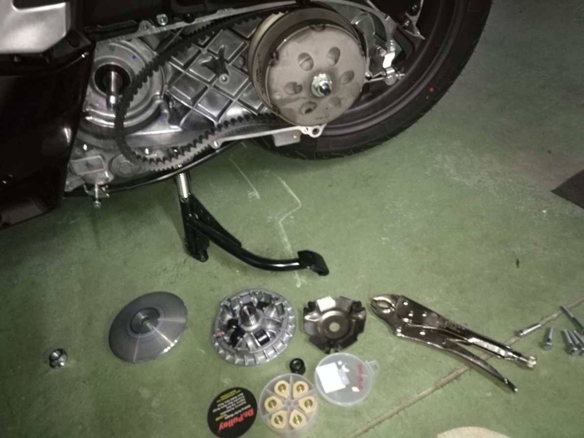

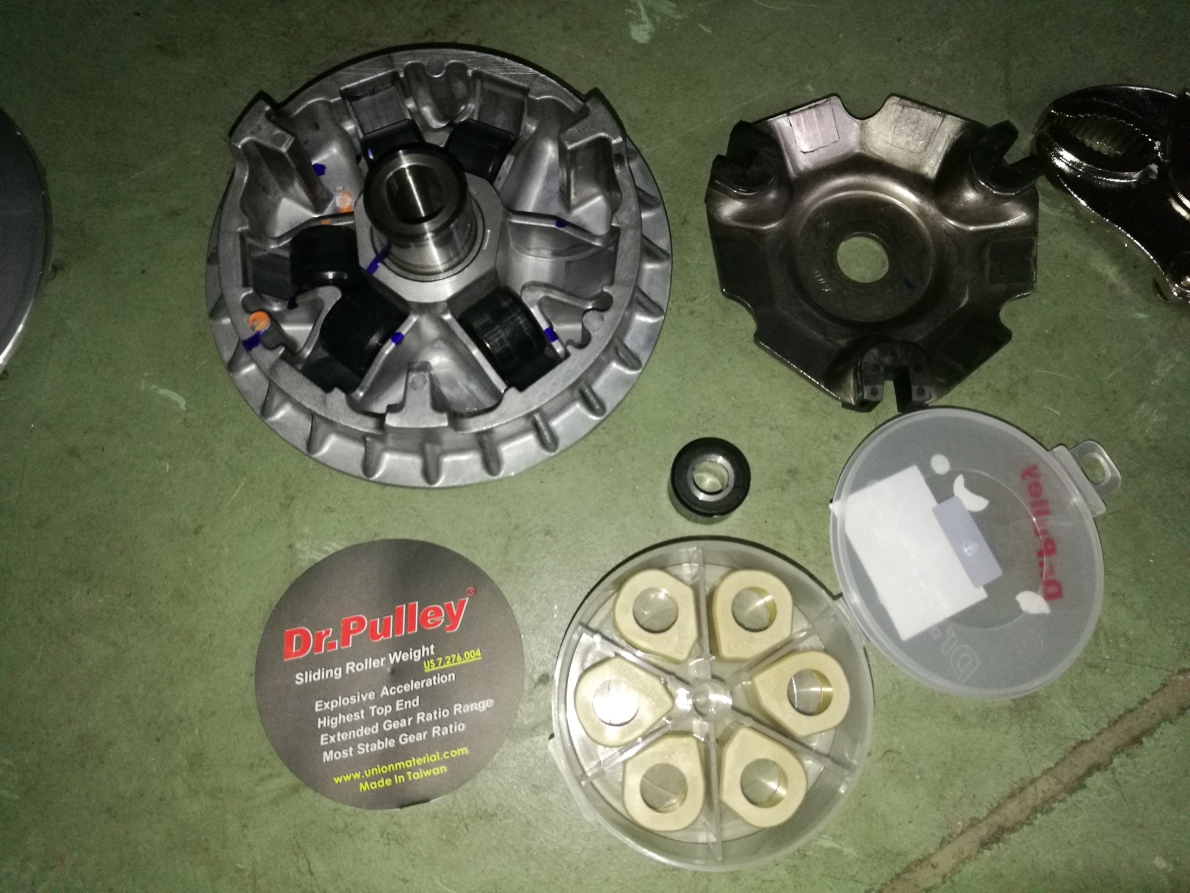

Re: Dr. Pulley & Contra spring testing

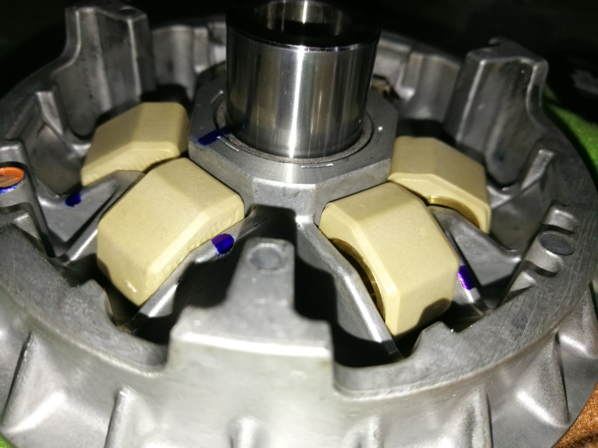

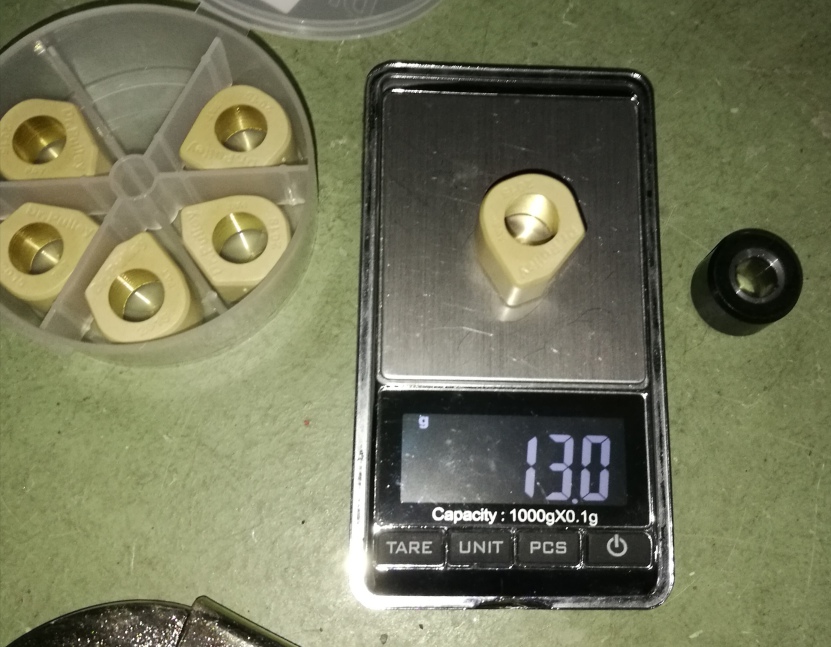

2 weeks old pcx got the pipe and siders. Siders should come as a stock part, such a difference !

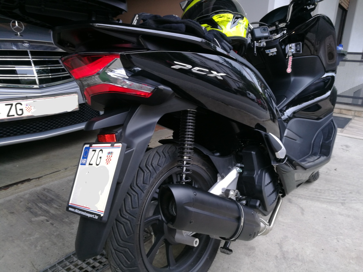

Is edit disabled after short time?
Typo for sliders

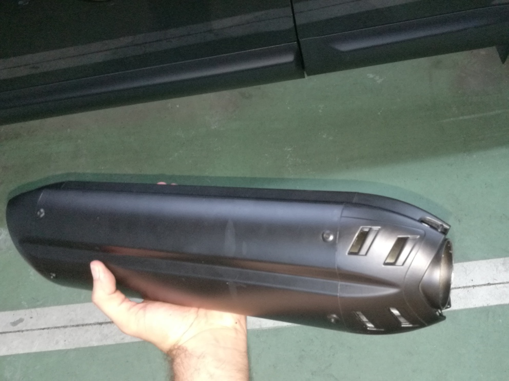

Exhaust is from aliexpress and chosen on purpose to look as close to original, not the 'akrapovic like'...
It costs even more, but once you change the pipe in front of muffler, you can.install any model as it is.universal 51mm ID pipe.
Pipe
https://www.aliexpress.com/item/-/32999997832.html
Muffler
https://www.aliexpress.com/item/-/32960352285.html
Will cut the meeting point on pipe(wide end) shorter so muffler will go a bit more.forward, and will be hung in middle(better looking)

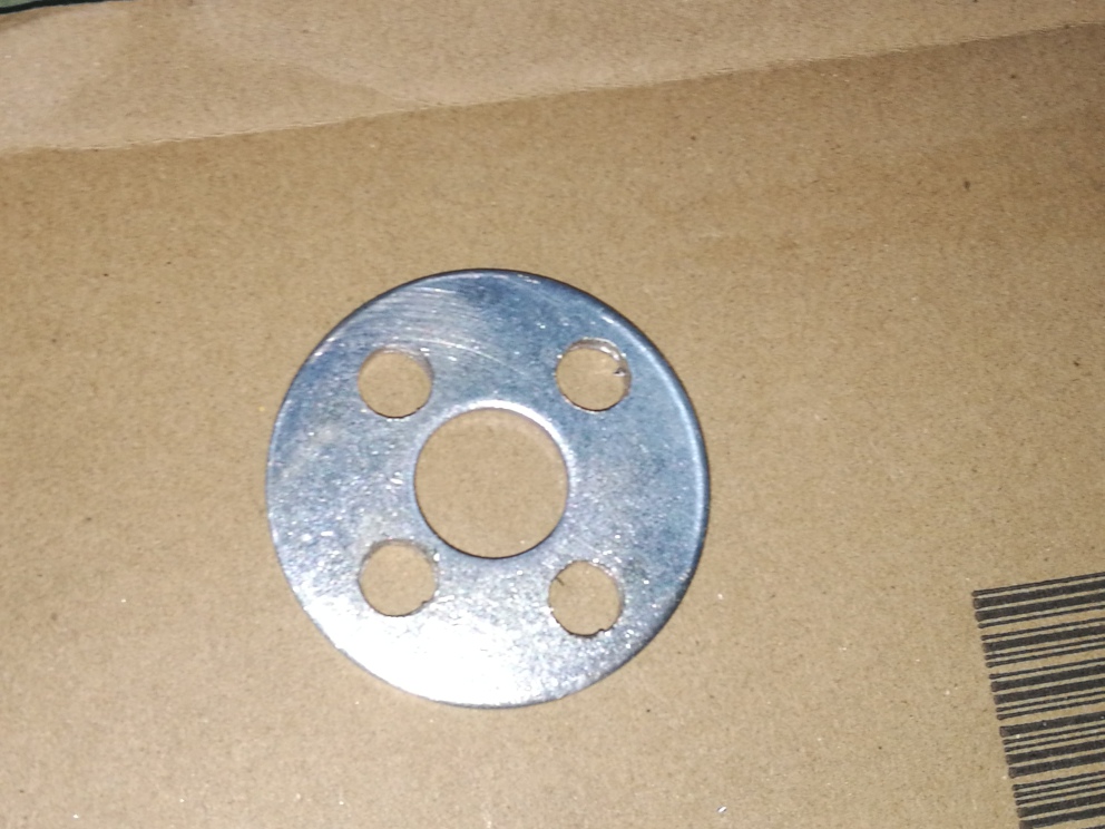

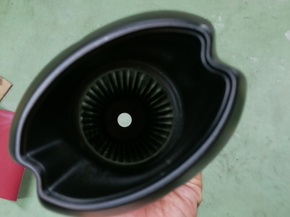

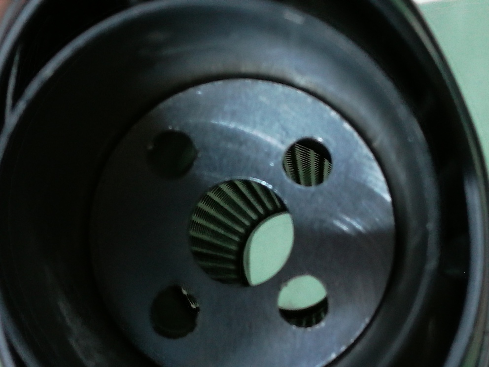

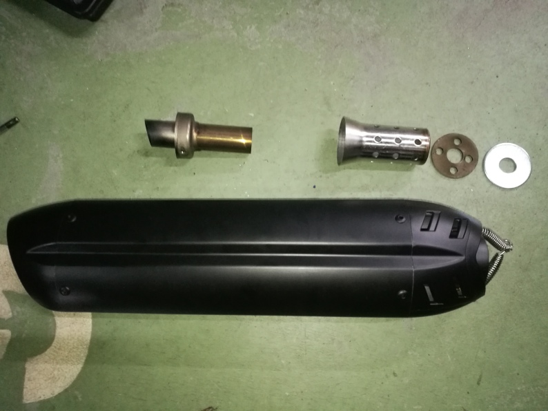

This works best after some riding...
Db killer (most left) installed
Perforated pipe for inlet, with plug on side to the muffler/back (it goes in reversed from pictured here)
Restriction diy rings removed(to the most right side on the pic)
This combo gives nice sound, (if someone wants more just take the rear db killer out)
And has some backpressure to maintain nice acceleration which can suffer if it is just straight pipe exhaust...
