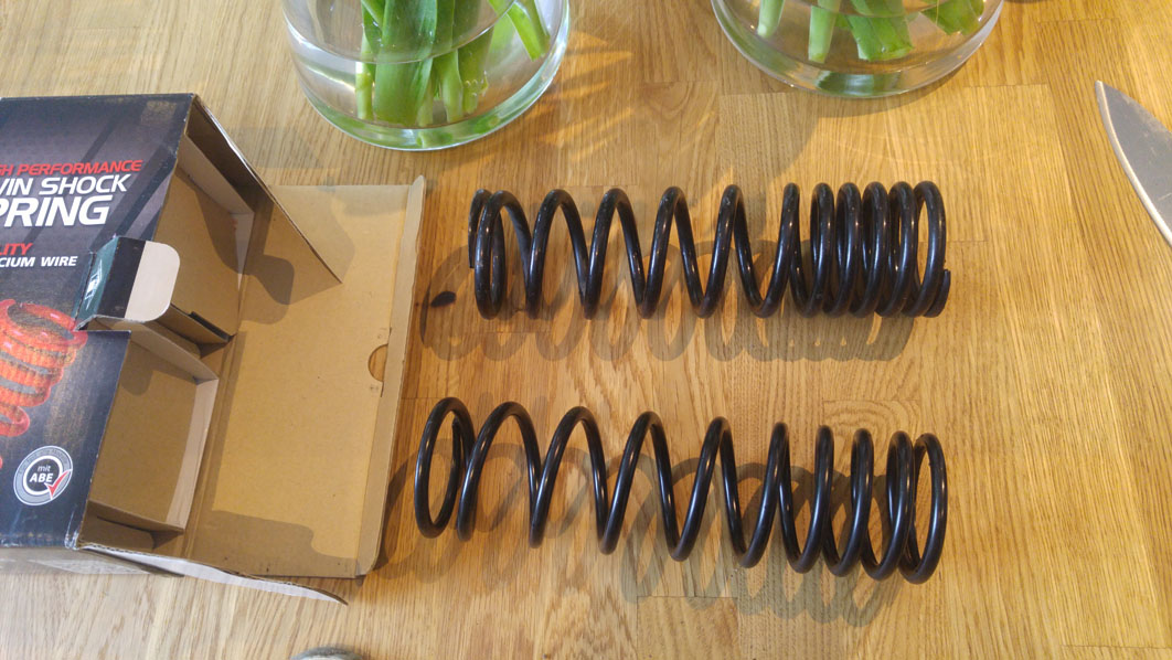

I received some YSS springs to replace mine- i have been cursing The YSS from the beginning as being really too hard and only comfortable when two up which almost never happens for me. I was really surprised at how easy it is to remove the old spring - i thought it would be a nightmare without the right tools. It will take some time before i test ride them back, with the confinement i decided to strip the bike almost completely to do the valves etc. It really would have helped if YSS would consistently print the spring ratio on their shocks and sellers would announce it.
Brooksbarn in UK has the following spring sizes at more reasonable prices that what i have read here:
YSS Black Progressive Twin Shock Springs 46-10-15-200
YSS Black Progressive Twin Shock Springs 46-13-18-200
YSS Black Progressive Twin Shock Springs 46-17-25-200
YSS Black Progressive Twin Shock Springs 46-20-30-200
YSS Black Progressive Twin Shock Springs 46-25-35-200
YSS Black Progressive Twin Shock Springs 46-25-45-200
I went for the 10-15 and if too soft i might order the 13-18 as another member mentioned here.
Top of pic is the old one, bottom the new.

Based on TomTom posting the different weight springs I would say that the 46-10-15-200 is the way to go. That would be the next step down from where I'm at and should be close to perfect. Well thanks to this thread, I just ordered a set from Brooks Barn thanks to TomTom. About $50 US. I went with the cheaper shipping so it might take a while to get here. I think the last set of springs cost me a little north of $100 (Ouch).

I'm in the same ballpark of weight, around 90 Kg with my gear on. I went for 10-15 based on solely on Macdaddy's feedback since i have no way to know what my original ones are. My target was to have the springs around 50% softer as mine, but it's shooting in the dark really. As i mentioned my bike is stripped down to the bone for now, but i did mount one of the springs on one shock- was surprised how easy it is to adjust pre-load compared to the original. Certainly softer for sure but only a test ride on the terrible roads here in Belgium will tell if they bottom out too easely or not. It will be a matter of days before i can test them, and i still have to mount the stronger springs on the YSS valves that are already in front forks.

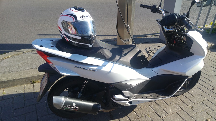

Just a quick feedback- i went to put some petrol and check tires pressure ( first outing on bike since two months). As you can see i still have to mount dashboard and windshield. I also changed the front springs with harder ones from YSS. I was worried the 10-15 springs for the shocks might be too soft- they're not. Still feels firm. I tested on terrible cobblestones street next to my place- never had the bike staying composed on this kind of roads, it felt like a constat hammering - not anymore, no more kicks in the back. Have not tested at high speeds yet if there are bottoming issues but i'm quite confident it should be ok. I preloaded the shock with 2 cm of preload i will fine tune that maybe a tad less. I'm happy.
First ride since so long, i had forgotten how agile and nimble the pcx is. More feedback when i ride it more in the next days.

I finished monuting everything and went out for a longer and faster trip on horrible B roads close to here. You will not regret it - My back and more notably my neck with full face helmet are saying thanks... Amazing it took me 4 years to find this balance. My bike is 30.000 kms now. Will never again buy rear shocks without knowing their spring rate.
