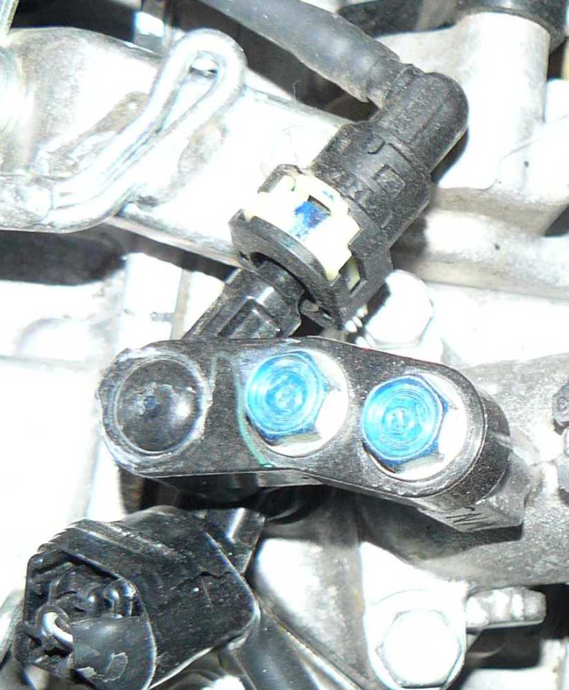

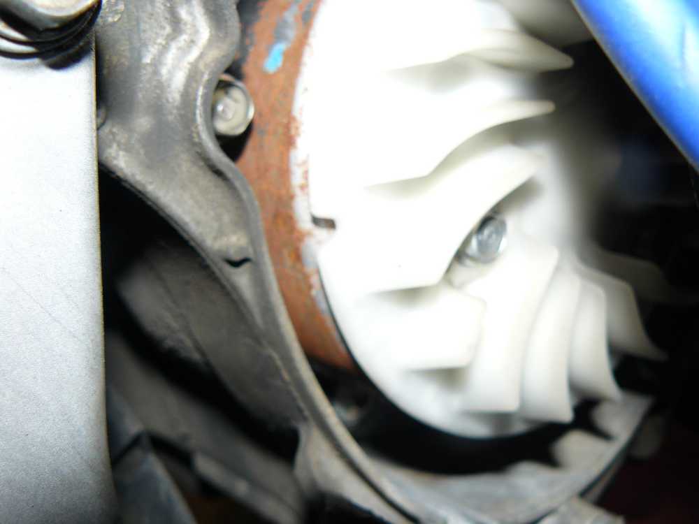

Some information for 125 ESP riders ....
The 2012 ESP model has some different fittings than those contained in the OP's photos. They are essentially the same, but the main differences are:-
1. Fuel line connector looks like this ....
2. The radiator fan markings now look like this ....
