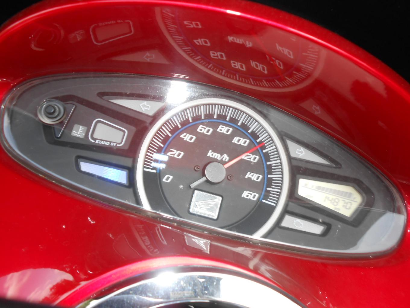

Mgalutia88 wrote:So what happened to the j. Costa test?
mine is a 125cc, coming up to 3 years old, 14,800km on the clock, standard air filter / exhaust, but J Costa variator fitted.
Down a long dual carriageway managed to get it up to 118kph (circa 73 mph) before the rev limiter cut in......
Went back home and got my camera, and tried again......unfortunately, the traffic had built up quite a bit and this time only managed 115kph (circa 71.45 mph).....
still not bad, but definitely my last time of "high speed" testing on the PCX....i'm 53, FFS....
