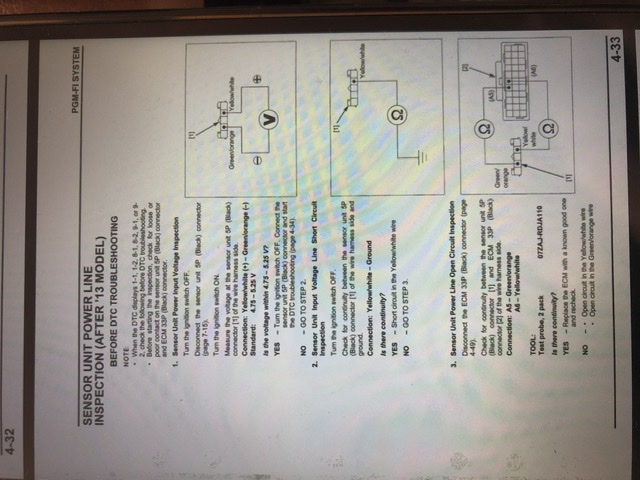

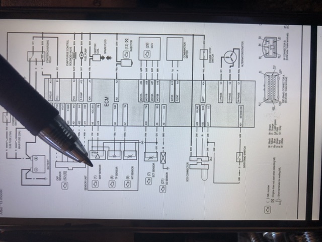

Re: 2015 PCX 150 sounds like a Rod Knock
It’s clicking in the front by the ECM
when it clicks, it accelerates..
Will be testing ECM powerline to sensors today
verify powerline comms and for shorts..
what is leading me to ECM faults, cleared DTC’s and set Zero calibration of sensors.. Plus i eliminated air leaks, all fuel issues, any oil bearing issues, and drive issues.. Nothing Left but wires and ECM
Retested for DTC’s and ECM is solid MIL light, according to service manual that’s an ECM fault.. Have to jump back n forth in manual from ignition and codes..
No Codes = MIL on then Off and stays off
This thing stays on..
It’s like i am so far Advanced in spark timing, that’s why I verified TDC to cam Mark on valve train, just didn’t go far enough i guess
But..
what are the ODDS, that this goes out within 24hrs of changing oil and air filter “?”
Quite sure anyone could be traveling the path i took..
Everything will be New on this bike, other than general wear
But..

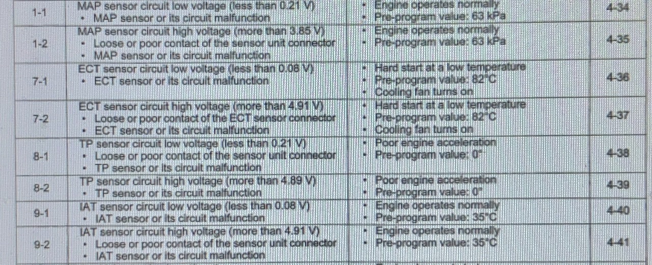

Traced all wires..
Verified all voltages.. ECM is okay thank goodness..
1st code i pulled out of this thing was 1-2
MAP sensor fault
I read this as 12
Watch this-
have to jump back n forth from Pre-2013 and After
21 or 2-1 o2 sensor
12 or 12-1 or -2 fuel injector
it’s the ONLY Damn sensor Left to replace relating to air/fuel
Tested IAC for proper operation, Good.. (thought it might be stuck open, Leaning A/F)
Lapeer Honda mis-ordered and sent the TPS sensor to Begin with..
I did not know it is a 3-way combination sensor
MAP-TPS-IAT
So it looks like ECM is locked at pre-program values of air temp, vacuum, and throttle position, even though i am riding through engine range..
Yea That’ll cause an A/F issue..
Maybe the clicking noise in the dash is related
Hope Lapeer Honda still has it, didn’t send it back to warehouse
MAP sensor fault
I read this as 12
Watch this-
21 or 2-1 o2 sensor
MAP-TPS-IAT
So let me explain what happened
Just by Coincidence.. ironical..
i No Longer do multiple things at once, with This PCX
it gets expensive..
Remember only 75% throttle? Since purchased..
Remember air filter plugged up? Badly plugged up..
Opening up air intake finally gave MAP and IAT something to think about
with MAP and IAT throwing numbers now, it finally took out TPS sensor
DTC 1-2 MAP fault
Notice DTC picture.. 0° degrees Default mapping
That’s Not air temp, that’s spark timing..
Supposed to be 12°
BAM spark knocking
Waiting on call from Lapeer Honda as i type this..
it gets expensive..
DTC 1-2 MAP fault
Supposed to be 12°
BAM spark knocking

Finished a day with my grandson
Line test and trace for any and all Opens and Shorts
ECM 33p harness to sensors..
All have proper voltages
All have clean connections
No shorts or grounding of any signal or voltage lines
Continuity is clean all the way to ECM
-tested a line, Then touched a ground point to make sure it’s clean
ECM still clicks when slowly taking off (it is the ECM that clicks)
Hard to keep 10-15mph, a touch more throttle and “Click”
off she wants to go
When the next heatrange colder spark plug comes in, I’ll ohm my plug wire
off she wants to go
