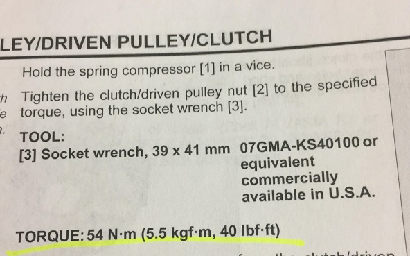

what torque do i se the 39mm nut at?
Re: so is this the sound of a bad bearing
?... don't know exactly which nut you are needing to torque eggman
eggman
Posts: 386
Joined: Sat Oct 01, 2016 6:07 pm
Location: gainesville ga
Post by eggman »
the nut thats 39mm on clutch assembly
here you go....
unnamed (1).jpg (71.92 KiB) Viewed 2814 times
