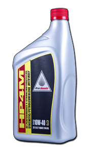

You people are missing something, wondering off the reservation in these oil threads again. Honda places value on the additive (Moly) for the little bikes oils. It's recommended in the service manual for both engine and final reduction gear box. It maintains the aluminum reservoirs as well as having proper lubrication properties concerning friction. We can do pictures if you like.
https://www.amazon.com/gp/product/B0039 ... UTF8&psc=1
Now stand by for a wide variety of opinion why this should be ignored

It's normal for Honda to want us to consume their own products..
Now stand by for a wide variety of opinion why we should just stick to what the manual says

I think you are right.. Avoid over thinking this. Any good quality oil , changed regularly, and the bike will out live your strictest expectations. Ride on, and forget about the advertising hyperbole. Honda does not refine oil ..they buy it !

Honda creates a scooter, that if properly maintained runs over 130,000 miles (from the longevity threads), obviously doing everything in their power to maximize lifespan, and people are questioning Honda's recommendations on how to get the most life out of them??? Seriously?homie wrote:You people are missing something, wondering off the reservation in these oil threads again. Honda places value on the additive (Moly) for the little bikes oils. It's recommended in the service manual for both engine and final reduction gear box. It maintains the aluminum reservoirs as well as having proper lubrication properties concerning friction. We can do pictures if you like.
I'm with @homie, use the right fluid for the job--Honda knows their machines.
Pro Honda Product Brochure (from Honda)
https://powersports.honda.com/documents ... micals.pdf
(Notice HP4S can replace HP4 and GN4, but not HP4M. @homie called it. And thanks @maddiedog for starting this all in the first place!)
