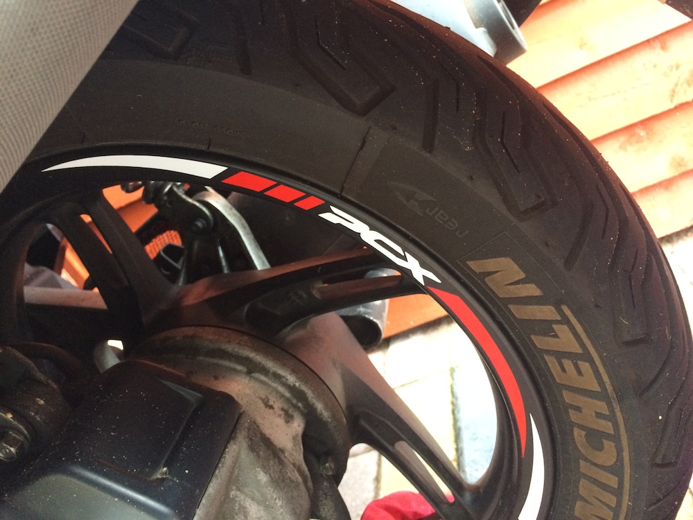

I checked the back one and that arrow points in the way the Wheel goes..
Re: My Honda PCX
Posted: Wed Oct 08, 2014 9:03 am
by jojo87
lol so what am I doing, i've taken the Wheel off...
is the Tyre correct or not?
as a few people on here have been saying it's wrong :-/
so as you're saying,
the rear one is correct as when the text is straight, the arrow is pointing to the rear of the Bike?

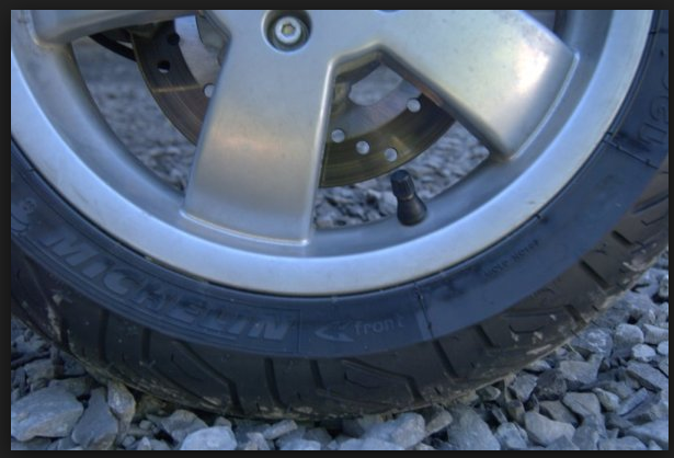

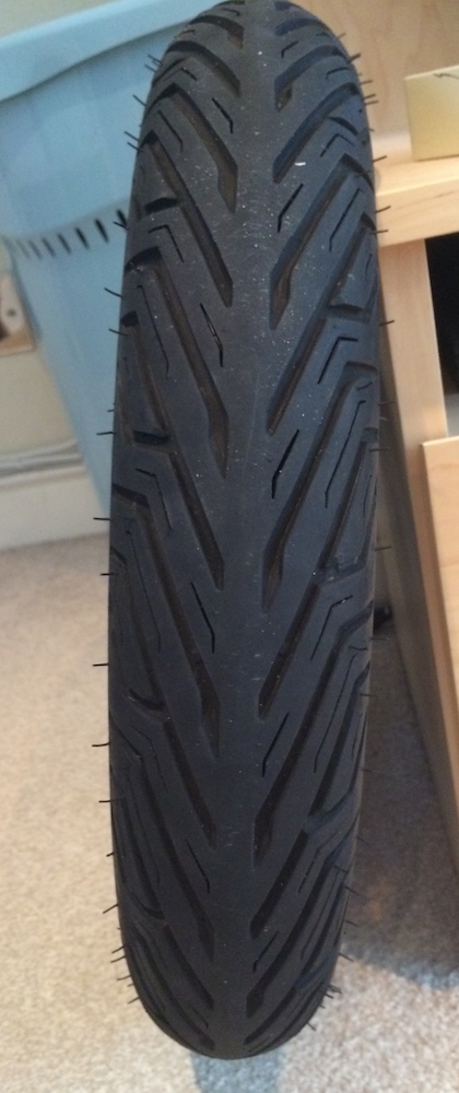

Picture worth a thousand words... you have made many discoveries by posting this thread. Sorry about your rim stickers bro. Apparently your Michelin citygrip tread should appear like this when installed correctly. As you can see that clearly shows your front to be reversed.

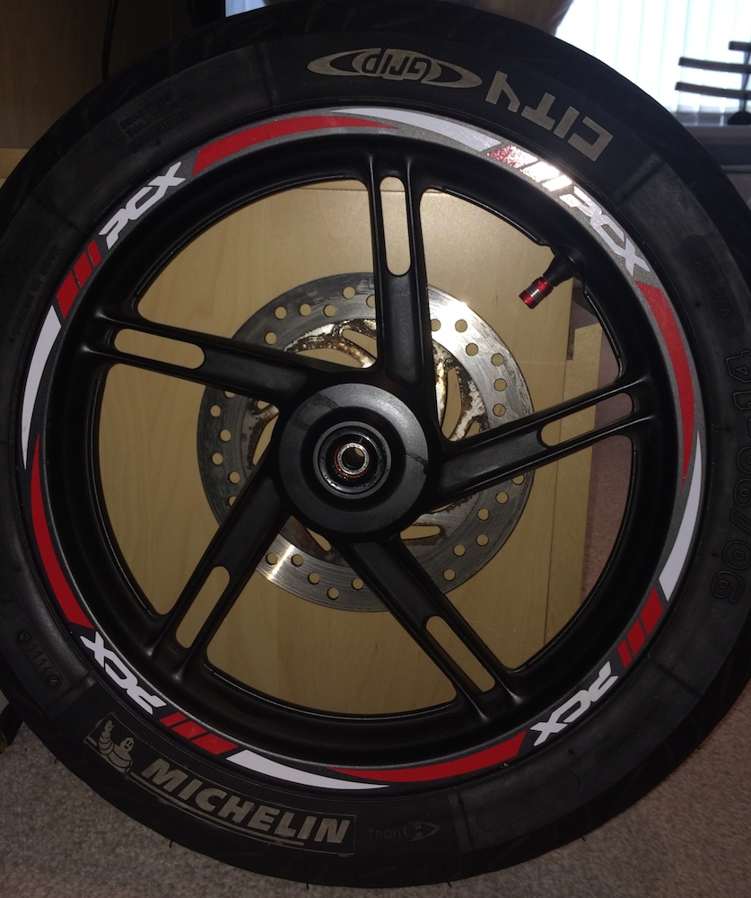

This is mine...
*front* text at the bottom of this photo, arrow pointing to the left
Just went onto the Michelin website and seen this... so it is on the wrong way then... as the arrow needs to point 'the direction of rotation'

The plot thickens with the picture of the rear tire. Do a web search for "Michelin City Grip directional." Michelin's labeling of these tires causes a lot of confusion. Apparently, the arrow is to denote rotation, with separate tread patterns for front and rear. Putting the words "front" and "rear" next to the arrows causes the confusion.
Double-check with your tire shop and don't be afraid to go direct to Michelin customer service to get the correct answer. Good luck.

Well homie got his photo of the front tyre thread, which is the opposite way to how mine it,
and then the photo I found on Google of the front tyre with the arrow the opposite way to mine,
so both of theres cant be wrong, so im guessing mine is... as I always thought the arrow is the direction of rotation anyway,
and then to see that on the actual Michelin website:
On tyres for a specific Front or Rear fitment, the rolling direction is usually indicated by an arrow.
When fitting the tyre on the bike this arrow must be pointing in the direction of rotation of the tyre.
but mine isn't pointing in the direction of rotation,
when it comes to the rear, the arrow points in the rotation and to the rear of the Bike...
STUPID ARROWS lol
