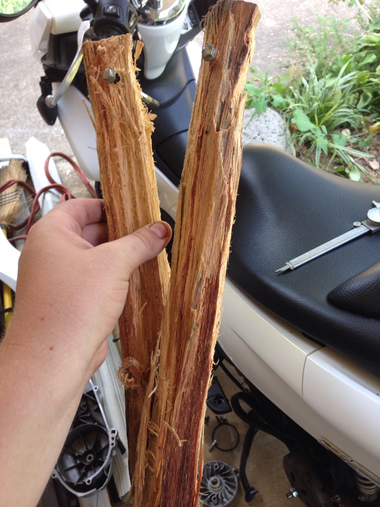

Posted: Sat Jul 26, 2014 3:05 pm
by logepoge1
Homemade variator tool

Posted: Sat Jul 26, 2014 6:41 pm
by dasshreddar
:) now that is a real man's tool there... :lol:
I would give you more props if you took the caliper off your seat and had a brick instead :lol: ;)
Re: How-To: Install an Aftermarket Variator
Posted: Sat Jul 26, 2014 7:00 pm
by logepoge1
Yeah the dial calipers were to see what size the nut was for variator. But the makeshift tool worked flawlessly. It's gonna be burnt though cause it is the core of a pine tree so covered in flammable sap
