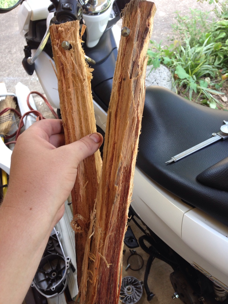

Homemade variator tool
:) now that is a real man's tool there... :lol:
I would give you more props if you took the caliper off your seat and had a brick instead :lol: ;)
logepoge1
Posts: 656
Re: How-To: Install an Aftermarket Variator
Post by logepoge1 »
Yeah the dial calipers were to see what size the nut was for variator. But the makeshift tool worked flawlessly. It's gonna be burnt though cause it is the core of a pine tree so covered in flammable sap
