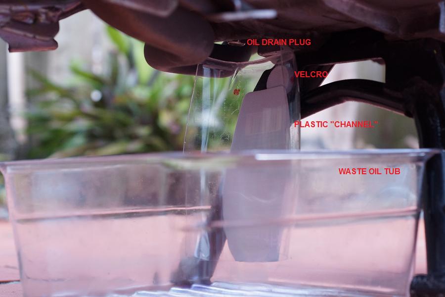

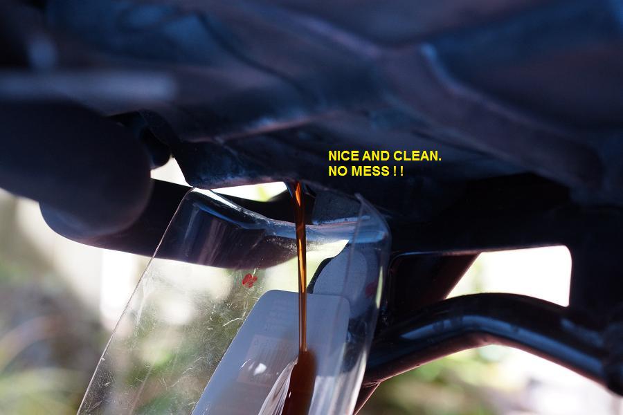

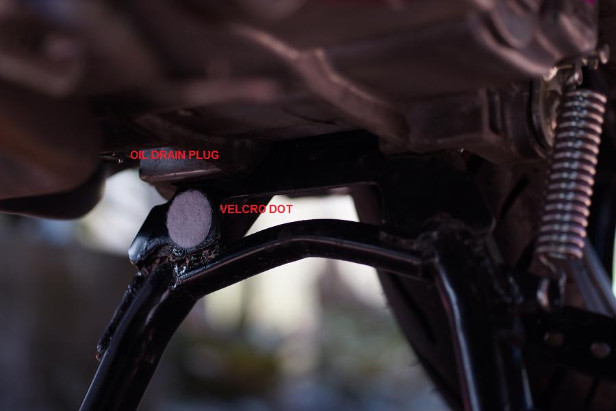

Thought I'd share what I use for my oil change. I change the engine oil every ~1,000km. I know this is overkill but fresh oil never hurt an engine. With a bit of preparation, I have managed to keep my oil change mess-free and quick.
This is my Oil Change Kit: Oil always drips down the centre stand, especially when it gets to the last few drops. I made up a plastic "channel" from an old plastic bottle with a velcro dot (hook) on one edge: I attach another velcro dot (loop) on the centre stand: And the plastic "channel" is then attached to the centre stand: No-mess oil drain: Also, made up a "funnel" from an old 1 litre plastic bottle with a short length of plastic tubing inserted through a hole drilled in the lid: After oil has drained and I have replaced the sump bolt, I insert the plastic tubing into the oil fill hole and secure the bottle with the hook on the scooter swing arm: I pre-measure ~750ml of new oil using a 1 litre engine oil bottle and tip the whole lot into the "funnel". It takes a while for the oil to flow into the sump but I don't have to keep watch. I place a piece of rag over the "funnel" to stop dirt falling in, and make myself a cup of tea.
Topping up the last few mls is easy with a small plastic oil bottle.
Hope above is helpful.

Borderline OCD but nice idea with the drainer stuck to the centerstand.
