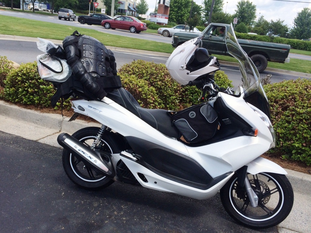

Bike loaded up. I have my armor draped over the back, and got an adventure-style helmet recently. You can just see the LED foglights on the front forks, they are each twice as bright as the headlights and INVALUABLE on mountain roads at night. We're stopped at Bojangles "fried chicken" (in quotes because I'm not sure if it qualifies as food) for lunch.
