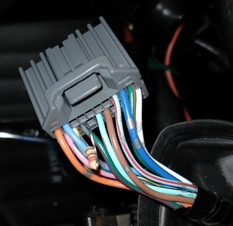

Fuel gauge fix.
Looks like I might be able to fix the fuel gauge accuracy. I measured the electrical resistance of the 2013 fuel sender when the arm with the floater is all the way up the sender has a resistance of 10 Ohms and 100 Ohms when the arm is at the lowest. I didn't what to bother measuring the 2015 fuel pump that's in the scoot, but i'm guessing that it's range is much wider than the 2013 fuel sender. For now I have added a 100 Ohm resistor between the fuel sender signal and ground, at the plug that plugs into the instrument panel. The gauge is now showing about half a tank left. Will find out Saturday if it fixed the issue. Will update with the results.
Two 200 Ohm resisters in parallel added to get 100 Ohm.

Gil - your work on this has been absolutely astounding, and I can see why you would now want to resolve this last issue. OTOH, fuel gauges are notorious for inaccuracy anyway - maybe just use the trip odo?
As I said - a stunning bit of work here.

GeorgeSK wrote:Gil - your work on this has been absolutely astounding, and I can see why you would now want to resolve this last issue. OTOH, fuel gauges are notorious for inaccuracy anyway - maybe just use the trip odo?
Thanks GeorgeSK, :).
I had to give it a try at least. ;) I always fill up my vehicles when the low fuel warning shows up on the dash. It's just a habit.
AND
The fuel gauge is fixed.
Today I rode with some Grom riders in San Jose, CA for about 200 miles, including the distance there and back home. I can now say that the fuel gauge is working properly. I had less than half a tank left when I left my home and didn't fill up until 15 miles after the last bar on the fuel gauge stated flashing. I filled up 2.138 Gallons into my gas tank. Disclaimer, I fill my tank to the rim of the filler neck. I'm satisfied with how the fuel gauge meters the fuel level and now I know that when I have four bars left on the fuel gauge, I have used one gallon of gasoline. Can't get better than that.
