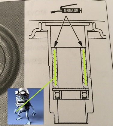

Grease should be placed/packed into the three groves in equal amounts, the round tube cover that goes over that part along with the two seals is supposed to prevent the grease escaping onto other parts. It seems in many cases Honda tech's did not add the correct amount of grease and/or bad bearings, as these seem to have changed on the new version of the driven face, final (there's the older x-x-640 part (from memory) and a newer one.

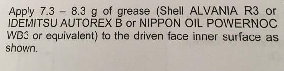

Could be grease quantity or quality is the problem. I have learned two things about this issue with Precious.
1. Too much grease will contaminate your clutch shoes costing you repair or new ones.
2. Poor quality grease can melt. The natural heat build up from constant friction on clutch operations could be enough to break down the wrong grease.
Use exactly 7.3 grams of the Service Manuals grease recommendation according to the product specifications and place it exactly as shown in this diagram. Product and placement is critical for the life of these two bearings found inside the FACE SET, DRIVEN.

I suspect than this failure (in my case at least) is due to the lack of grease, maybe there is even no grease at all ! It begins so quickly after the bought, that's very strange.
Maybe some PCXs are build in factory with no grease on these bearings (mistake, oversight...) and those bearings destroys very quickly...
If they change me the bearings (or the whole assembly of face driven) maybe that could be a good thing to check the grease sometimes, maybe on each oil replacement.
The type of grease shown in the manual seems quite hard to find, do someone knows if it's very special ? (thickness, temp resistant...)
I got some high temp graphite grease, but it's very thick and sticky, i don't think it is fine on high revs bearings...
I got some PM600 Military Grease too, it's used by SRAM for a lot of parts of MTB forks and shocks, it is a very good grease, a lot of pressure resistance, this could be fine, but maybe the heat resistance is not enough !

Assuming that Shell Alvania R3 and RL3 are the same, I think it has now been superseded by Shell Gadus S2 V100 3: https://www.smithandallan.com/products/ ... vania-rl3/
