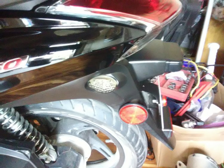

Well, my scoot is now back together, with the exception of the small cover just above the fuel door.
The new large panel between the dash and the fuel door is not for the American PCX as I noted in an earlier post.
So, while there are no turn signal holds, which I like, there also wasn't a hole for the parking brake.
I made a hole for the brake and it looks very good.
My big flood lights, which were in the location of the old front turn signals are now gone.
The deer wreck took out the one on the left side, so, I removed them both.
I still have the spot lights mounted to the forks.
Here's some photos!!

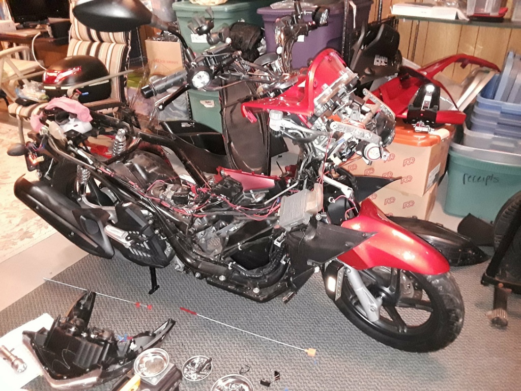

At this time I have my bike completely apart in my basement, and I am installing all sorts of lights in the headlight assembly...which it had no holes for originally, so I made some. When I am done I will leave the lights on that are on the sides of the front fork, but the new HS5 bulbs in the main light assembly should be much brighter than the original bulbs.
It looks like a mess in my basement right now but the special connectors I ordered came in yesterday, so I will be putting the bike back together soon.
Meanwhile, is your bike fully assembled, aside from that cover you said was missing? (I am still not sure which part that is as your pictures look like the parts are all there.)
My bike right now: :-/
My bike torn down.jpg (364.52 KiB) Viewed 3804 times

Wow, Mel46!!! That's a serious take down!!
I've thought about adding lights to the headlight assembly, too.
Take pics of your progress, I'd like to see how it goes and what parts you use!!

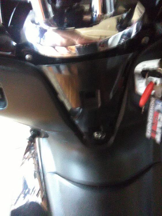

Yeah, it's all together, except for that one little panel.
It's the one that covers the single bolt in the large panel below the dash.
It has two little white clips that hold it in place.
I used those clips, because the new big panel below the dash has no turn signal cutouts.
And instead of the cutouts, it has two of those clips that help hold it to the scooter.
My son has them sitting by his computer at the dealership.
I have to remind him to bring them home tonight!
Here's a blurry pic of where the panel should be.
PCX 2-27-2016-5-sm.jpg (63.75 KiB) Viewed 3798 times

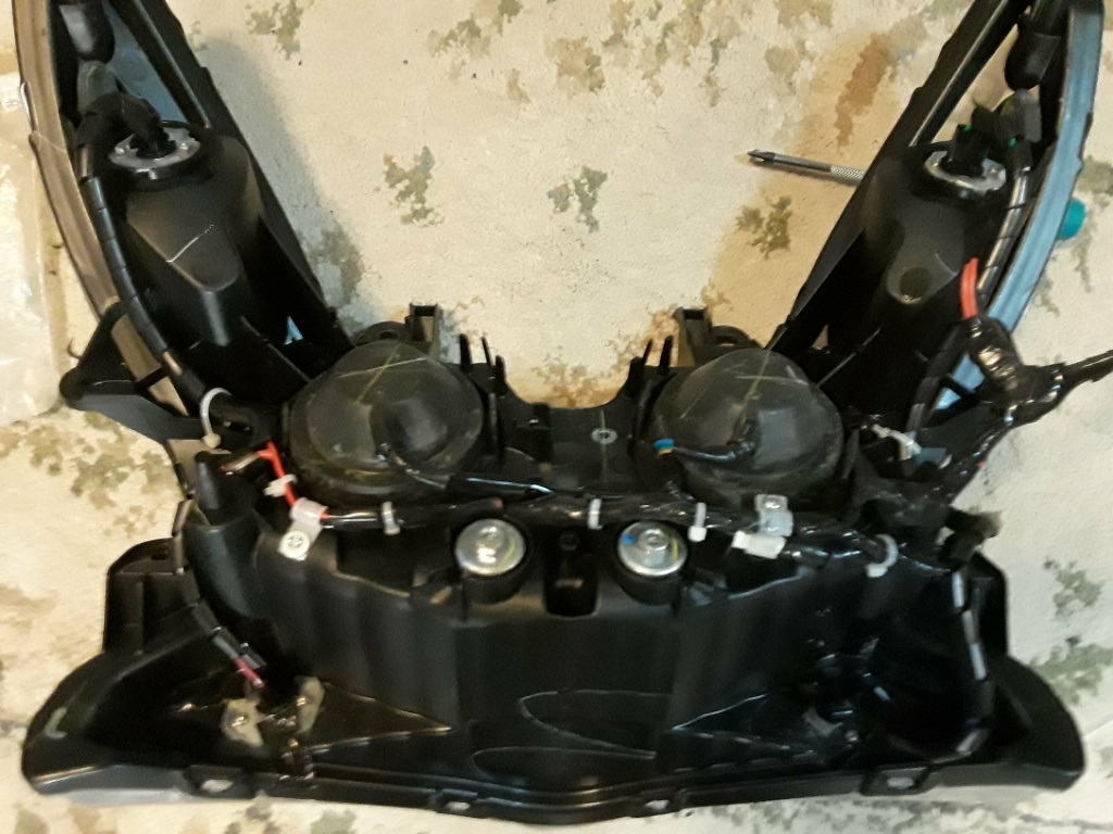

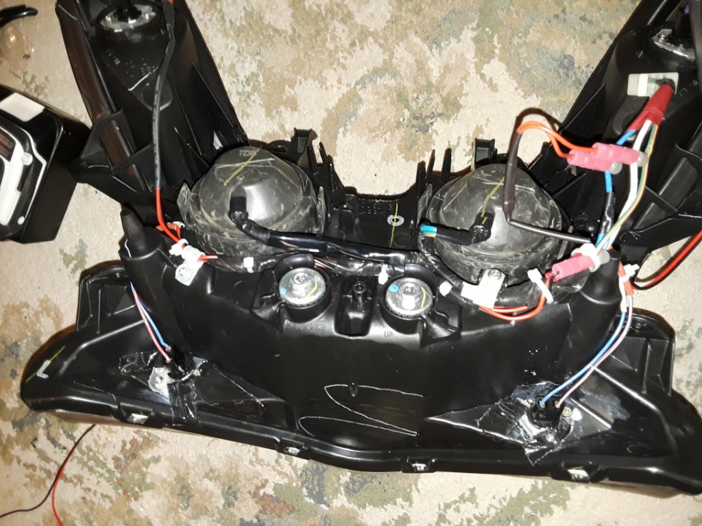

I have already posted this picture previously, but here is a picture of the light assembly. I have been waiting for some special connectors which came in the mail yesterday. They will replace the Posi-taps that are in the picture. Those were in place in order to test the lights, to make sure they will all work...which they do. I hope to connect those today and finish wrapping the wiring before putting everything back together. I also cleaned up the red wires you see on the frame that go toward the back. I didn't need for them to be so long since they handle the Bad Boy horn and the strobe lights.
Headlight assy.jpg (330.98 KiB) Viewed 3796 times

What did you use for the lower lights that you added on?
I've been looking for sockets that I can press in.
I've seen them before at auto parts stores, but I want something a little smaller.
I like the idea of adding more lights to the available places!!
Dave
KG5VOO
Re: My 2013 PCX 150
Posted: Wed Feb 28, 2018 3:11 pm
I used T10 sockets (194 bulbs) for both the top and the bottom. The bulbs are LED on top while the bottom ones are the shortest bulbs I could find. They won't light up the world but at least there are lights there. In order hold the lights in, I drilled the holes just slightly larger than the socket. Then I made custom socket locks out of some scrap plastic and used little screws to hold them in place...after trying glue which could not handle the torque of locking the sockets in place.

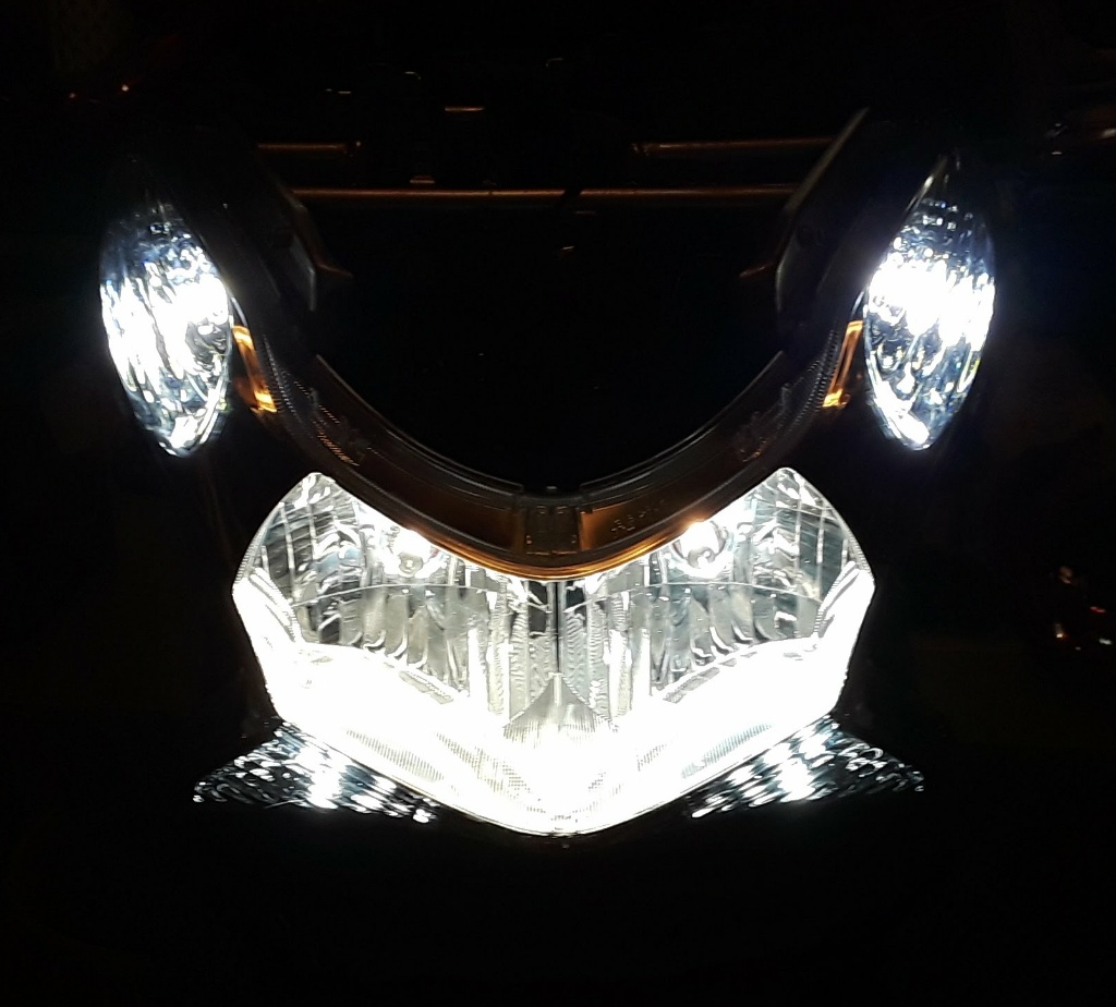

Well, I finished the lights today. Here is a picture of the finished back, and one with the lights turned on (bike started). By the way, these extra lights are wired so they stay on whether I have low beams or high beams on.
Headlights on.jpg (196.91 KiB) Viewed 3793 times

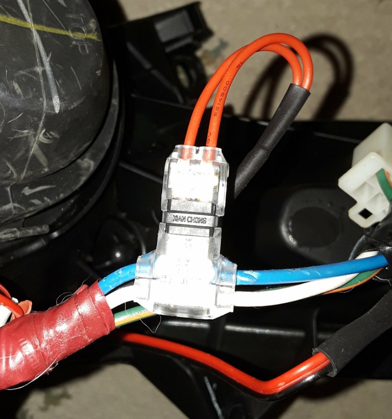

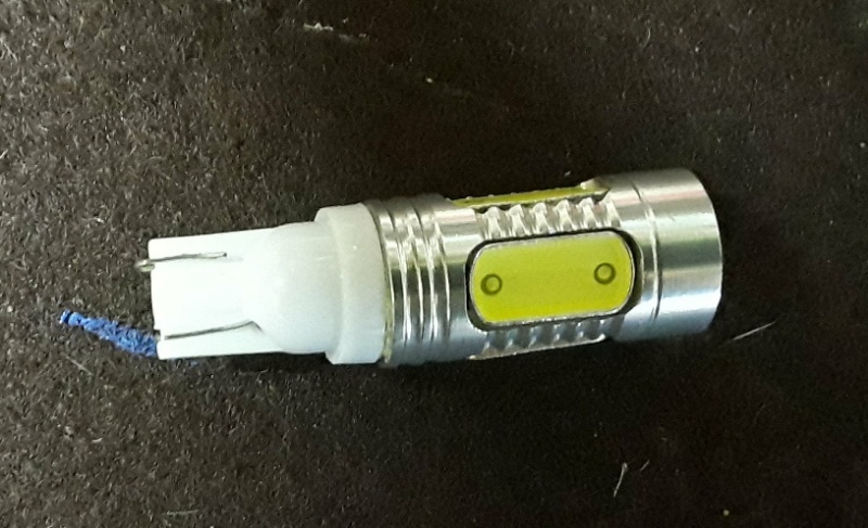

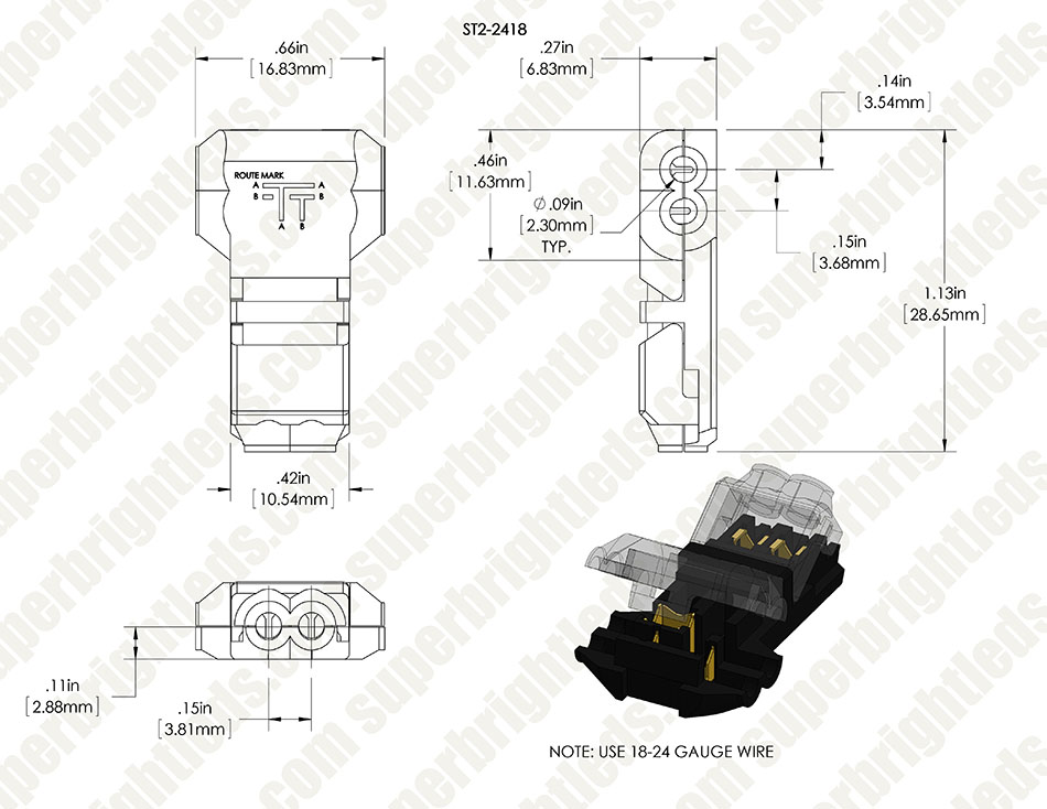

Here is a picture of one of the special connectors I had ordered. Also, here is a picture of the top led bulb I used.
Led bulb.jpg (138.68 KiB) Viewed 3792 times

Mel46,
That looks sweet!!!
What headlight bulbs are you using?
The only LED HS5 bulbs I could find were $70 a piece.
I really like that look, and it makes you more visible!!
Great Job!!

I used the standard HS5 bulbs that were given to me. They arebrighter than the original bulbs that came in my 2013 model.
Today I ordered some supposedly brighter led bulbs for the bottom position, so I will see how they work out before reassembling the bike.
I still have the LED spot lights on the front forks as well, so I don't think I will have any problem seeing and being seen now.

BTW, are the "T" connectors you are using able to come apart or are they solid connections?
Re: My 2013 PCX 150
Posted: Fri Mar 02, 2018 12:07 pm
The T-connectors open on both ends. After you put the wire in you clamp the connector closed. I used one of my wire strippers to clamp down so that I wouldn't press down too hard. The stripper has a narrow head, so I pressed each side separately in order to get a good bite into the wires.
There are two sizes of connector. Both say they can handle 18 gauge, which is what the headlight wires are. I got the smaller ones because I am using 20 gauge wire for the LED lights, which made it a tight fit for the 18 gauge.
They have a locking mechanism for the top once you press them down into the wire. After that I used some of my silicone tape to wrap the connector to make sure it would never come loose. I really was surprised and pleased at how small they are. They have double and single wire connectors.
https://www.amazon.com/Wire-Connectors- ... +connector
