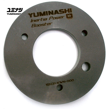

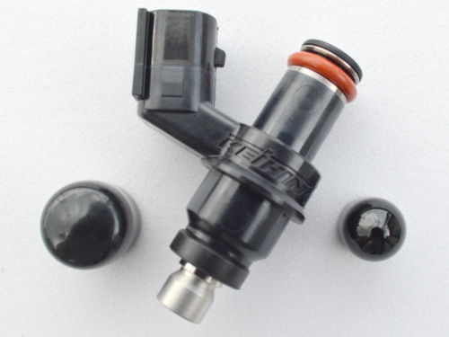

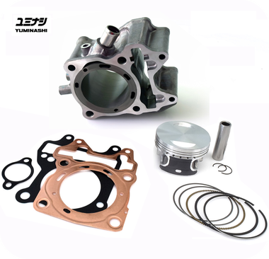

hi hello .. this week I want to see if I'm the one next to mount my yuminashi kit on my pcx.

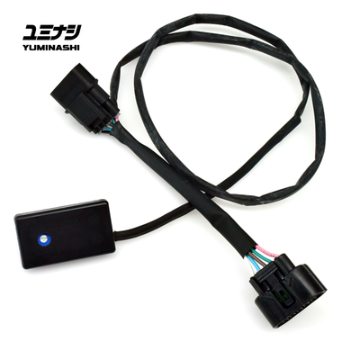

is the complete 164cc kit, I'll also fit the final gear kit, the AFR (injection driver). as well as the gasoline injector of greater debit "tuning of model honda cbr 150cc" and inertia power booster .
I will try to insert here the references of the material, my pcx is a 125cc 2010 model of the jf28 engine.
YUMINASHI FUEL-ADJUST CONTROLLER (5-PIN TO 5-PIN),38772-KWN-000A
44T FINAL GEAR SPROCKET SET, COMPLETE WITH SHAFT (PCX125 / SH125i)
23430-KWN-440
INERTIA POWER BOOSTER SET 15431-KWN-000
164CC LIGHT BORE FLAT DECK CYLINDER KIT (PCX125 V1) (FOR 125CC HEAD) 12103-KWN-600XA
Honda CBR 150 Keihin injector assy (Tuning CBR 125)16450-KPP-T01

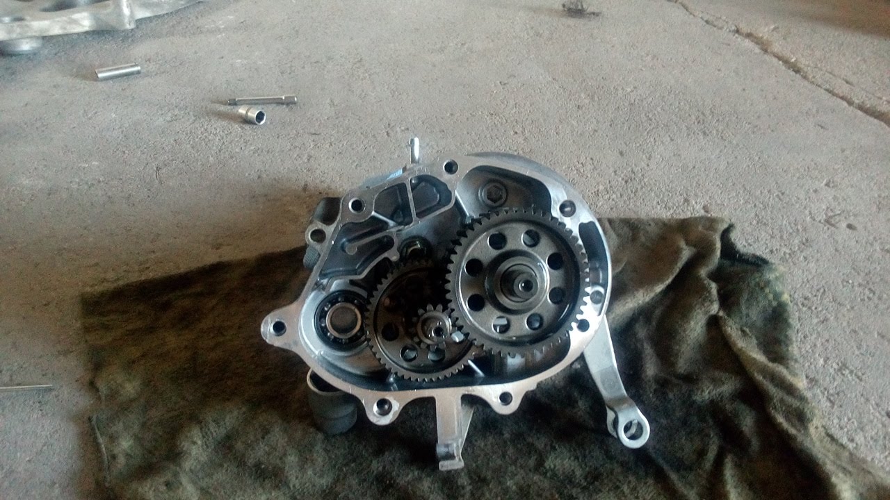

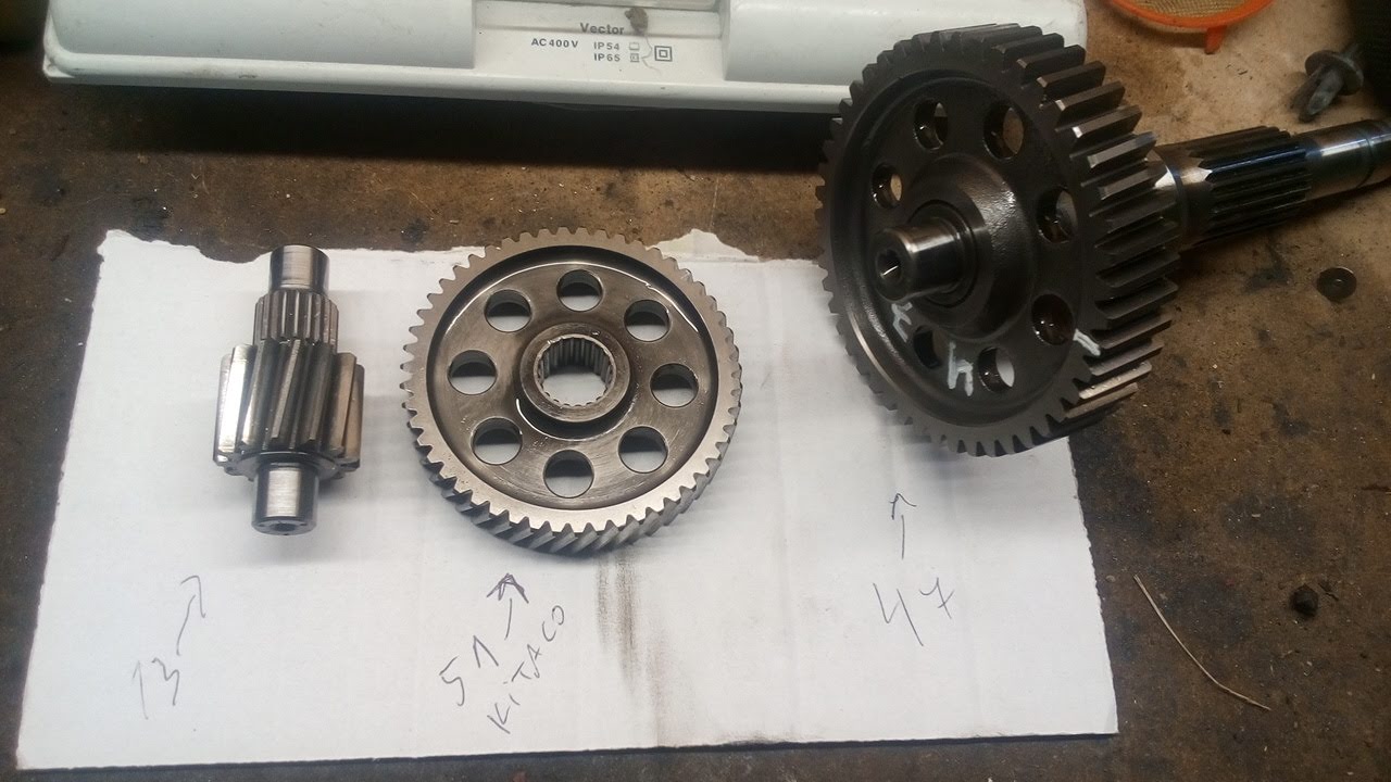

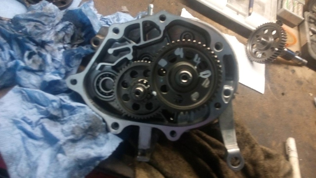

Hi .. as I said today I started to disassemble .. in the photos you can see the box (the sprockets) of which the secondary shaft is already kitaco with 51 teeth (I can not remember how much was the origin but only for here the bike was going well as you may have seen in previous posts, until today my box was 13-51-47) but from today it became 13-51-44 (this is my new box velocities).
new kit will enter the cylinder kit (see photos on top) afr kit (injector controller) pair of bridgeston sc tires, and the new painting of the rims. for already the rims ..lol soon more photos ..
however if anyone needs the measurements of the box bearings (model 125cc 2010 v1 jf28) I will have the pleasure to provide. contact me .. I will try to show you soon what I have done so far ..

Now we have the boxes of the box available to play on pcx:
Original 13x53x47
Intermediate 13x51x47
Medium 13x51x44
Intermaximo 15x53x45
Max 15x51x45
